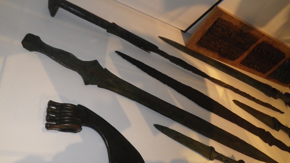

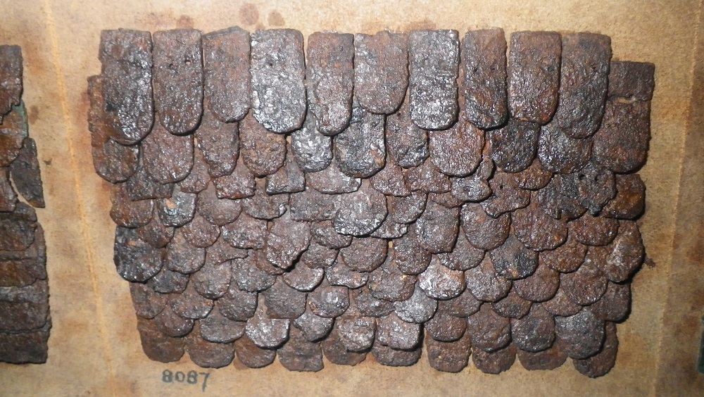

Anton de Vries
Posted: Mon 07 Dec, 2015 1:52 pm Post subject: |
Actual Roman scales from the museum (Allard Pierson Museum, Amsterdam) where I work.
For a sense of "scale": it's the middle patch in the background of picture 2.
Sadly I have no info other than that it's Roman.
Attachment: 141.15 KB
Attachment: 319.35 KB
