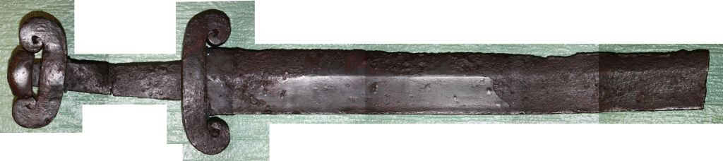

PostPosted: Tue 17 Nov, 2015 2:44 am    Post subject:         Reply with quote
Here is the photo I've dug up online
 Attachment: 62.63 KB
Never take life seriously. Nobody gets out alive anyway.

PostPosted: Tue 17 Nov, 2015 1:11 pm    Post subject:         Reply with quote
Here is one from Niåtsosjaure, Jokkmokk parish, Sweden. According to F. Androshchuk it was found on the shore of lake Niåtsosjaure and could possibly be an indication of trade between people in Norway and the Sami.
Total length: 65 cm
Upper guard: L 7; H 1-1,7; W 1,5 cm
Tang: L 8,5; W 1,8-2,9 cm
Lower guard: L 8; H 0,8-2-1,8; W 2-1,2 cm
Blade: W 5,3 cm
 Attachment: 86.92 KB
