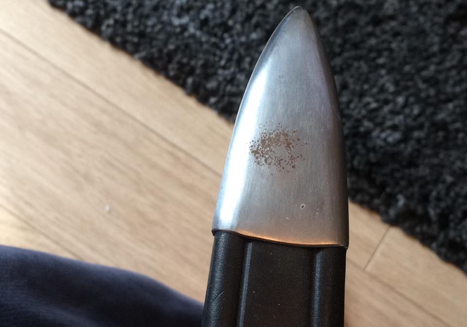

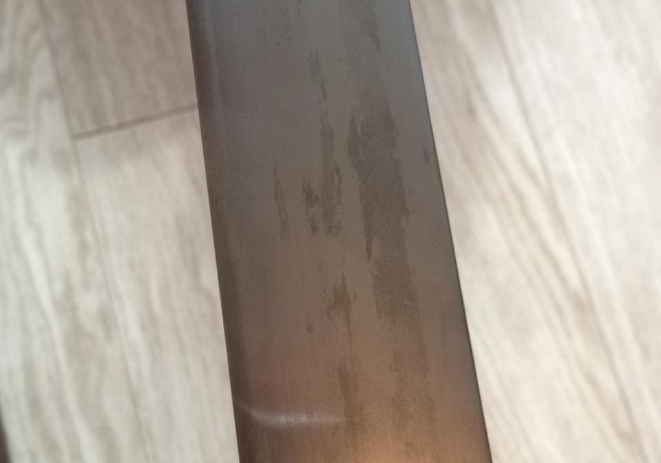

Right, now this has now set the scene for my request to you guys: How can I best maintain my sword? I am worried that there is evidence of starting rust on the scabbard metal + to a lesser extent discolouration of the blade. I am happy to buy whatever is needed, but I just do not know what to get. I would also love to know if there is anywhere in the UK I can take it and be taught how to properly maintain it as at the moment I am just relying on youtube videos.

Attachment Guide: Varterklinge 1 & 2 are pictures of the sword by Lutel, Discolouration 1 & 2 are photos taken today of blemishes to the metal.

Blacksmiths won't help you. They aren't swordmakers. They're blacksmiths.
Read the article. It's good advice. You can't mess it up. Don't overthink it.
If you just wipe it down after you touch it or use it, you'll be fine. If you start getting patination (like the photos you show which are likely caused by fingerprints) then use some of the products mentioned in the article. You'll be shocked how easy it is to clean a sword. Its not a big deal.

Thanks all for the advice. I cleared all the pitting etc and now the sword looks good as new. Happy
I used both the myArmoury maintenance guide and the following video. Perhaps this will help someone else in a similar situation.

Renaissance Wax is also an excellent preservative for use swords, knives. etc. Nice choice for a first sword. I've owned several Lutel pieces, I like them.

VERY nice!!! Congrats on a beautiful sword. I've had good luck with mineral oil for keeping rust at bay.
