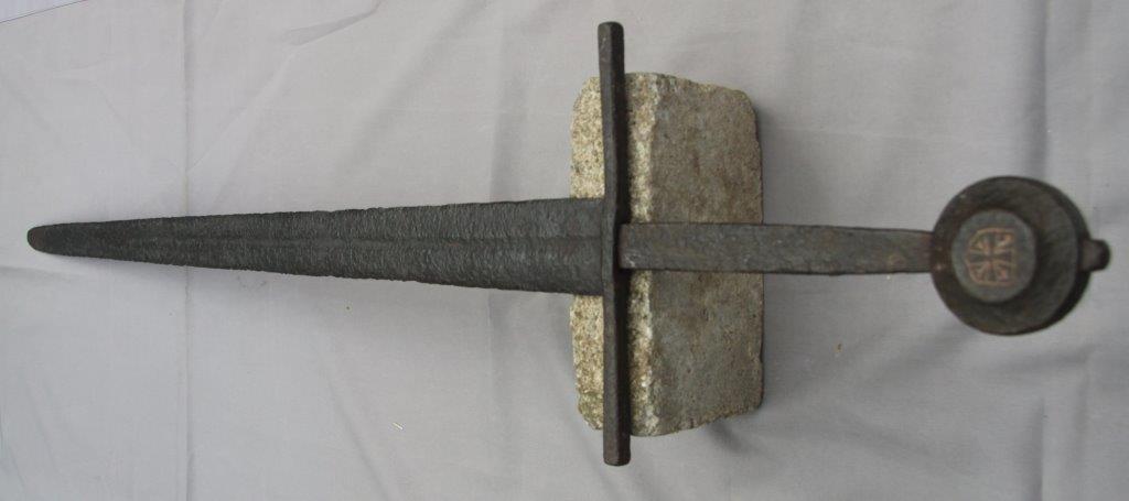

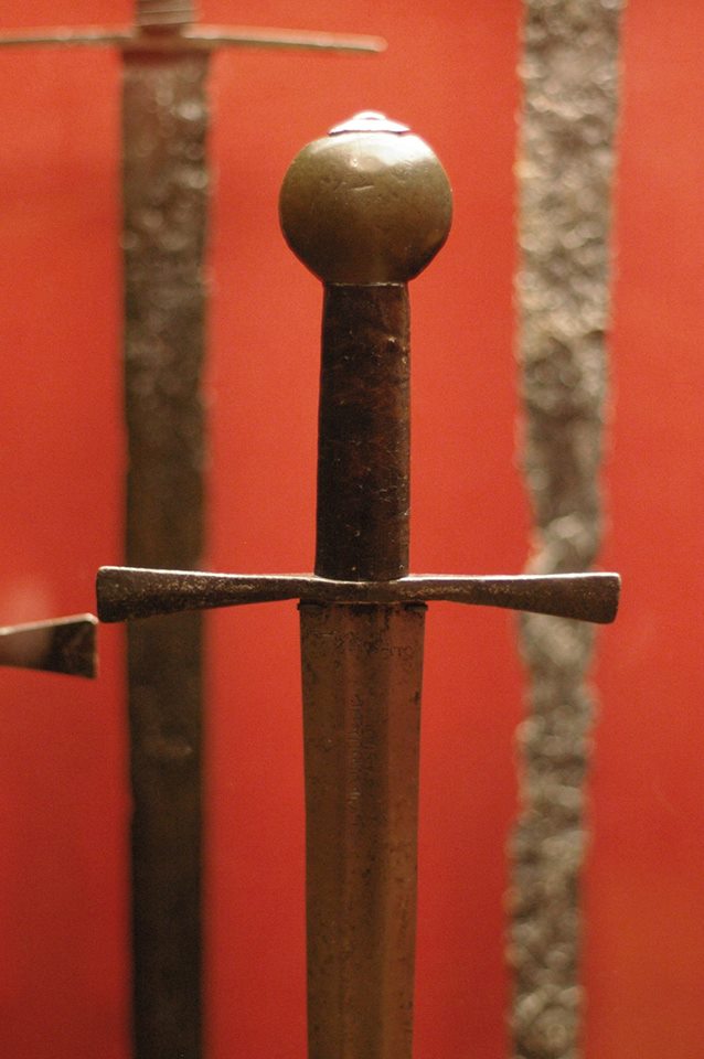

I'm searching for a very specific type of medieval hilts. This type has an flat disc-shaped pommel (Oakeshott Type G) and a tang, which rises over the top of the pommel. A protruding tang is very common for swords with pommels of Oakeshott Type I-K (see picture 1 for an example from Bonn, Germany) , but I can't find examples for Oakeshott Type G, except one sword from a collection in Paris (see picture 2).
So here is my question: Do you know any analogies in the 13th and 14th centuries?

I think he's asking about hilts that, put short, combine a simple type G disk pommel with a peen block.
And he's right, those are rare indeed - if they exist at all! I can't think of a single one myself. As far as I know, type G pommels faded from popularity before peen blocks became a thing. Even the one pictured in the opening post probably did not have a peen block, IMO; as far as I can tell, the pommel has simply shifted down due to corrosion and thus exposed the end of the tang, which was originally peened flush with the pommel (like on all historical type G pommels I know of).
But, more likely than not, the very moment I say type G pommels did not have peen blocks, someone will post a picture of such a thing. So the most I'm willing to say is that I've never seen one myself.

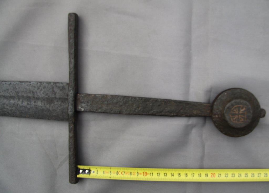

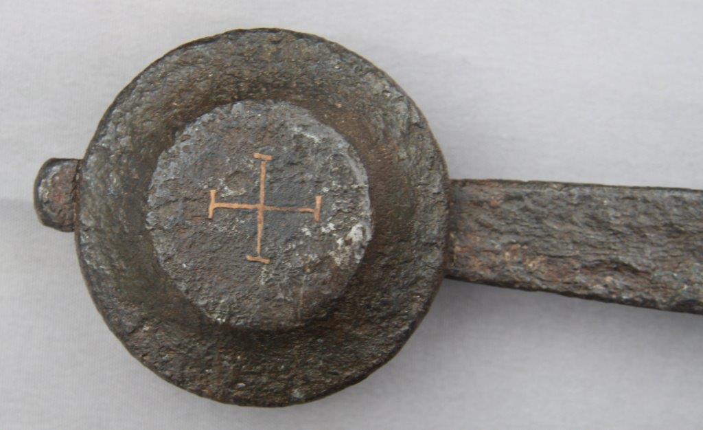

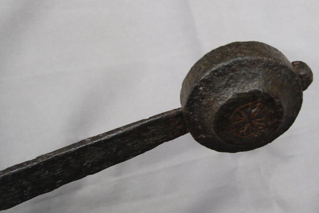

I own one great war sword type XII with type J or G pommel "with a tang, which rises over the top of the pommel"
See below pics.

That doesn't look like a type G pommel to me, but it is a very attractive piece!

No, that's a very clear Type J. (And a very nice one, too. )
The Type G is the simplest of the wheel pommel forms, just a plain disk, often with slightly convex or concave faces. No chamfered edges or raised centers.
