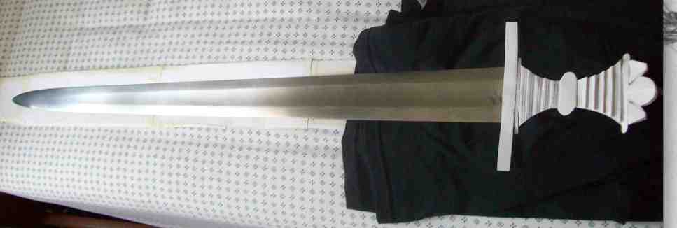

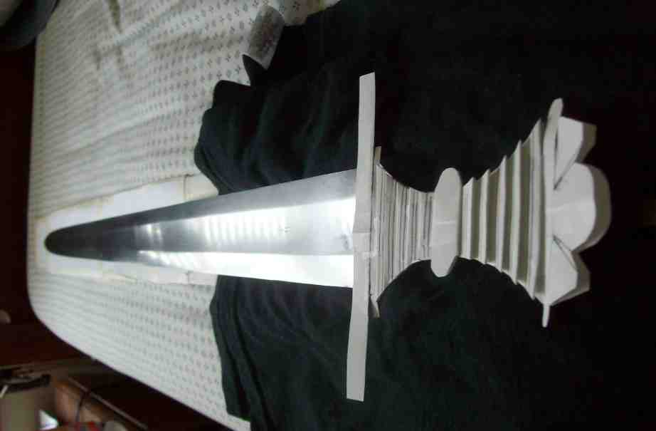

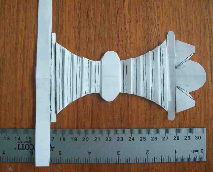

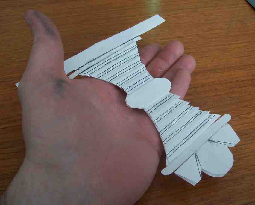

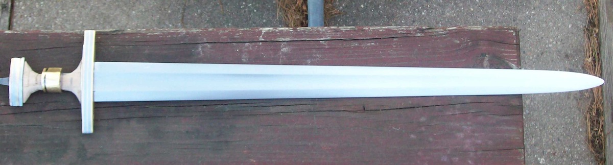

I've never done anything like this before, but I've decided to try my hand at hilting up a blade. I bought an Albion Second blade off a forum member here, and have yet to do anything to it. My initial hilt designs I abandoned slowly, as I could never really see them being pulled off well by myself. As of late, I have been a part of the crowd bit by the 'Migration-era Bug', and decided to check out some earlier hilt styles, as I find them beautiful and fascinating. I then began to play around with the idea of an 'Adventure Sword' (I recently started playing multiple Legend of Zelda games again) and I decided that I wanted a usable sword with a fantasy/historical merger. The paper mock-up is the initial design. A thin (sideways) metal cross-guard with a wasp-waisted grip, and a metallic pommel, taken from a carved South african tribal knife. The waisted grip is clearly based off of the metallic Kragehul/Nydam sword hilts, but will be done in overlapping metal strips, with the edges providing a pleasant 'scale' grip (after they have been sanded a bit). The drawn lines represent a bulged line in the metal strips--like a hammered-in riser.
I plan on adding a decent bit of mass to the hilt, as I have no issue swinging a 3lb-ish sword for a long while, but would like to have something a bit faster feeling (gotta have good recovery swings against monsters Surprised ).
The result is something that is a historical nightmare, but seems like it would feel good in-hand, and be quick, sharp and relatively stiff blade to kill foes with, while not being too long or heavy for dungeon-style combat. The blade is a Geibig 4, with a slightly overground profile, which I take to mean narrower, not thinner. It does seem a little bit stiffer than Albion's other Geibig type 4s, which aren't too 'bendy' to begin with. I may change the design as time goes on; it is rather odd-looking...

It doesn't look bad but I would shorten the cross a bit. Happy

Looks cool.
Over all I like the look. I assume the crossguard will be shaped in the 3 dimensions so it goes with the rest of the hilt.
So the cross guard might look cool if it had thinner tips than the middle. Giving it a lenticular look when viewed from above. I don't think it would have to be super extreme but enough to flow from the rest of the handle. I hope I'm explaining it well.
But can't wait to see the final product as the initial mockup has potential.

I would personally prefer a thinner cross, like a type 1. Additionally, a thinner central profile and more elegant waisting would look better, I think. However, the tang is literally as wide as the central waisting, and so I am somewhat stymied there, as I don't really want to remove material from the tang. As for the cross, I played around with a wider, thinner style, and a shorter, thicker baltic-esque style. I'm still not sure exactly what I want to do with it yet.

I like the looks of it. Of course I'm a little biased, that is my favorite blade type/profile. Perhaps as Luka suggested a slightly smaller cross, but at the same time method of construction will enter in if the project gets past the paper stage...if you go for sandwiched material construction like a migration era weapon that will likely drive the shapes somewhat.

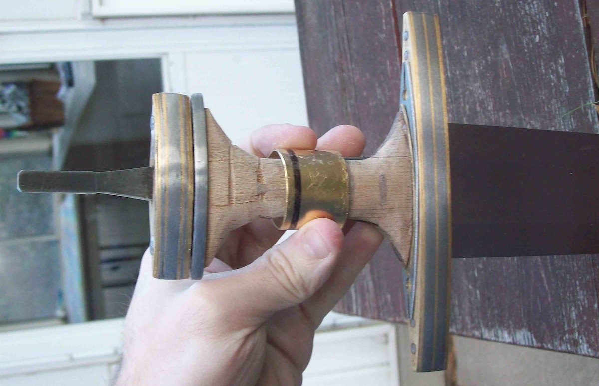

Finally got something of an update--had to scrap first design and construction methods partway through. Then school and finals and my job got in the way, and I just had a few hours free time this week to work. New guard is setting up with glue now. I put it between two steel plates and pieces of paper in the vice, and beat the handle/twisty part closed with a hammer. It's in there tightly. Checked with a flashlight underneath the piece before and after gluing to check for light slits--none showed up.
Turns out, epoxy is a fiddly beast--and sticky like you won't believe. Those ether bonds won't let go for nothin'.

I've had to scrap ideas tons of times. turns out that some ideas work well when you have the correct tools to make them work. but nothing beats the feeling of making something your own.
your getting to a spot that i usually hate though. punching the upper guard of pummel. i don't know what tools you have available to you but no matter what i use, i always hate that part. I've honestly though about just hot punch and drifting guards just so i wouldn't have to deal with a drill bit walking all over the place or slipping out of place. but if you have a some kind of mill, that would work best.

I'm likin' what I see, man! The sandwich guard looks great so far. Don't ever be discouraged...we only earn from our mistakes. I , personally, like the longish guard on a 'Viking-inspired' sword. I'm sure it will be a wild lookin' beast when you're done with it! I have a pieced-together wallhanger in my living room right now with a 5-lobe Viking pommel, quatrefoil Claymore guard, and an OLD Toledo-made blade that I love! Don't be afraid to mix it up....It's your sword. Big Grin ......McM

I'm seeing how this goes--it's an organic process that sort of materializes/evolves on me as I go. I plan on using the hole drilled in the center (not visible above) and using a jeweler's saw to cut out a rectangle. I'll then fill to fit and add the top brass plate with the blade cut-out to the guard and stick it all together. I was nervous about the guard being heavy, but with the rough-shaped plates as is, the POB is about 7-8'' out from the blade shoulders. I can add some more weight and it should be fine

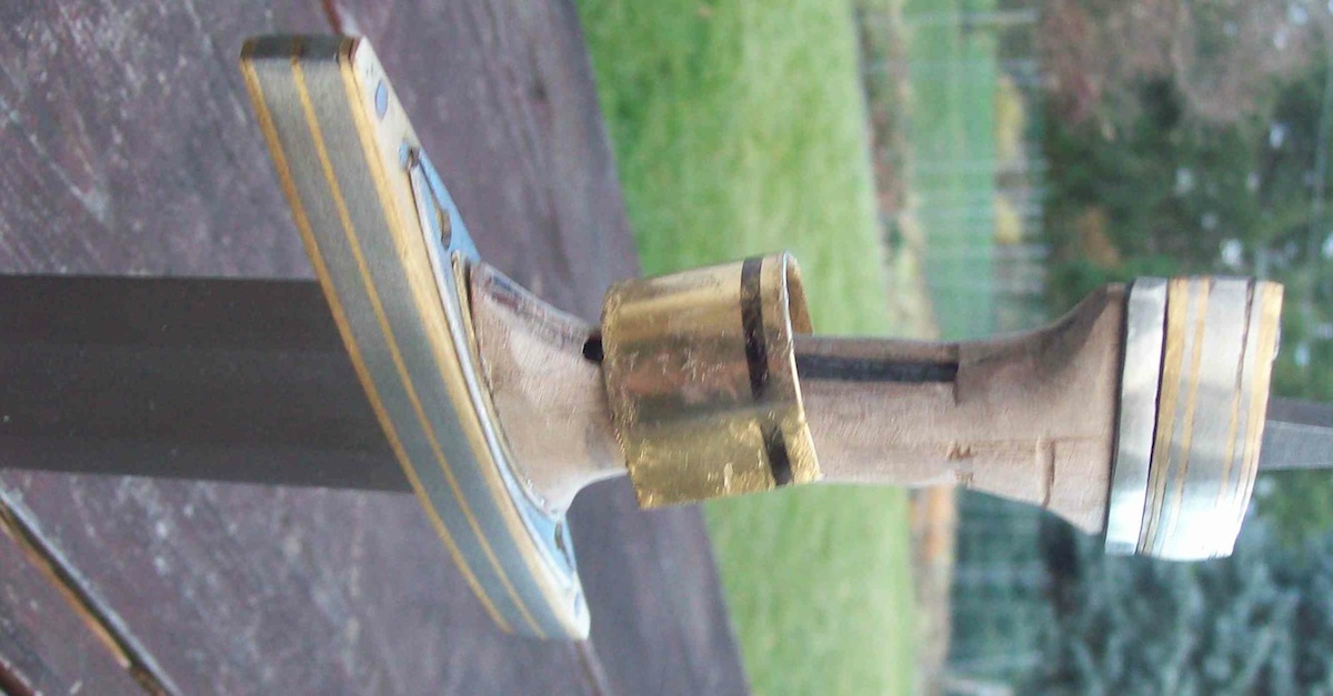

Getting closer: gotta etch the blade and need to do a a final shaping/finish pass over all the metal bits to get them to line up just right, and then peen it, cap it and wire-wrap the grip. The weird metal bit is for a riser with a sheet metal base and red glass inlay. Almost there...

You've surely taken the term 'full-tang' all the way home. That's lookin' great, brother!............Two thumbs up............McM
