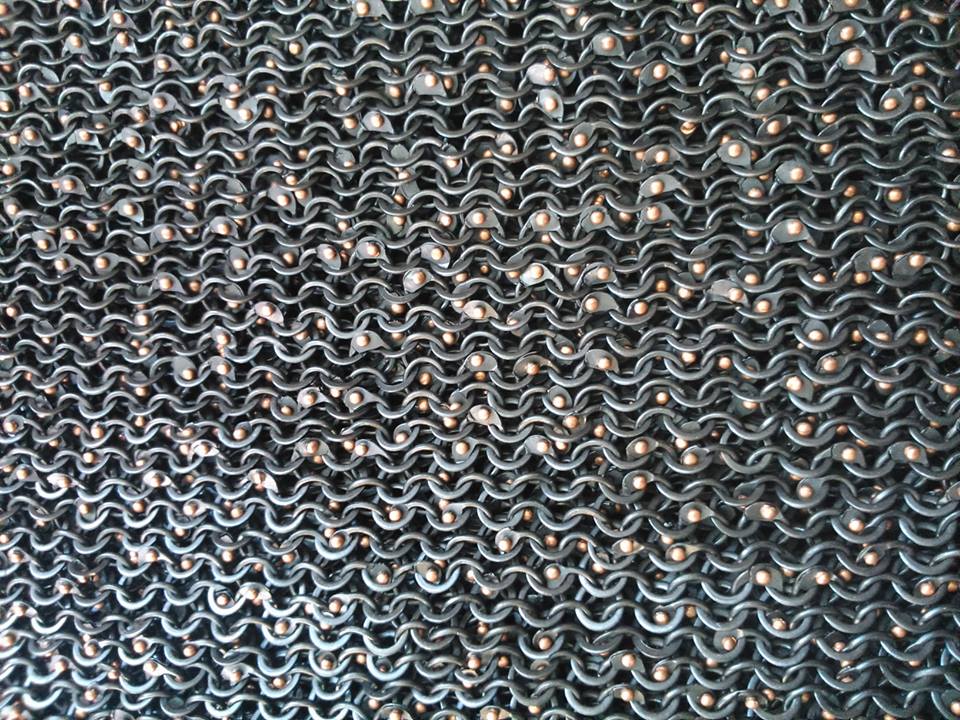

I have wanted to get such a mail coat for a long time and have tried several different makers over the years but had no luck - recently Matt Bunker introduced me to a new English company - Armoured Up who were not only able to provide a coat with copper rivets but also have tailored it, too.
The original is a mass of corrosion products but the links are still visible and the copper rivets were revealed using x-rays. It is difficult to tell exactly what the original link size was but it is around the 6mm internal diameter. That' the size that Armoured Up has used on my coat. Unfortunately, very few other details can be gleaned from the remains of the mail, which now exists as a congealed heap. There does appear to have been rather a lot of it, so it may actually have been two garments.
I have added a picture.
Why copper rivets were used is difficult to say, but the Sutton Hoo coat isn't the only one.
 Attachment: 177.46 KB

I thought that the Sutton Hoo mail was 6mm outside diameter, not inside. I'll dig up the report and check. The problem is that there are no mass producers of mail that do links that small. IIRC there a custom mail maker in England called Tony Whittaker who has worked with copper rivets before. He might be worth contacting. Another is Mark Chapman. Their mail would be a lot closer to the original than the Indian mail in your photo.

Dan -- it isn't Indian mail -- whatever that means. It was made in England by Stephen Rhodes of Armoured Up.
The sizing of rings in the report (Bruce-Mitford 1978 page 232 is ) 8 cm and this is qualified by the word 'estimated'. The ring size chosen at 6mm internal diameter produces a similar external diameter to 8 mm.

Paul Mortimer wrote:
Dan -- it isn't Indian mail -- whatever that means. It was made in England by Stephen Rhodes of Armoured Up..
The links are imported from India - they have a distinctive "soda can ring pull" appearance. They don't look anything like historical European mail.

Dan -- we will just have to disagree. Having seen quite a few surviving pieces of period mail from various places in England, and the Continent, I think that it is a good approximation and does resemble actual finds.

Here's an excellent museum photo of the Vimose hauberk. Zoom in to 100% and look closely at the riveted links, especially around the tears and the neck hole where you can see them from all angles. You'll see they look quite different from those posted here.

I am not saying that the new mail looks exactly like the originals in all the close details - I did try to get that done via other makers but I could get no-one to take the project on as I explained in previous post. What I am saying is that the new mail is a very reasonable reproduction and for most purposes perfectly adequate.
This is also the first attempt, as far as I know, to replicate the effect of copper rivets; it is around that, I feel, that it would be most useful to have a discussion.

I can certainly see bronze rivets being used as would have some strength as well as being decorative. Pure copper rivets? Na-ah. Too mushy. The report referenced above clearly states copper alloy; that's museum speak for some variant of bronze.
Paul if you can't see the difference between mechanically flattened overlaps on Indian rings compared to no similarly flattened overlap in western or eastern mail... then please continue to enjoy your commission. Happy

Just keep in mind the large stamped tabs look nothing like historical mail (at least up close), are likely to make for a weaker construction and can potentially interfere with the way the weave moves.
