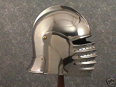

While I do not like to use reproductions as a basis for study, this will have to do as I am unaware of any online pictures that are similar to the previously referenced.
Reproduction by Tom Justus.
Notice how just plain BLAAAHHH the cheap helm looks in contrast. The helm you referenced is just plain wrong. The lines, shape, style are completely inaccurate in comparison. Shape, construction and proportions come into play, for certain. Without having it in my hands it is hard to tell how it would fit on a person's head, but I would be skeptical of being able to move in it once it is on.
The broad arms coming off of the visor are inccorect. The "tail" that they have on the helm has no way of articulating given its current position and location of the hinge rivets. It should be cover the entire bottom portion of the helm all the way up to the back of the jaw area... this will allow it to articulate up and down freely. The brow reinforce is much too short/narrow to portray a decent representation of an original.
The shape of the skull is simply wrong. The straight edge on the "skirt" of the bowl is wrong and will cause it to wear funny.
I have probably missed a few things as I looked over it only briefly. However, this should give you something to go by.
The thickness... unless you can measure it yourself to ensure that it is on the thicker range of the 16ga scale, I would be very suspicious... even then, I would not let someone hit me with a stick while wearing it. The blows delivered in the SCA are not conducive to historical representation. hey are concusive blows. The heavier the helm, the more of the impact the helm will obsorb. The lighter the helm, the more of the blow you skull and soft-tissue/brain will absorb. Think concussion. You do not want your brain to rattle around inside your skull. Get a heavier helm and allow the helm to absorb the impact instead of you. This is why most SCA armourers will only make helms out of 12-14 ga. Only the import companies who have no tie to the customer are trying to pawn these lighter helms off as safe.
The decorative rivets on the helm displayed in this post, btw, are used to hold on a liner.
Anyone else have thoughts on the subject? This was my $.02 for what it is worth.

That's a beautiful helmet Brian, thanks. That style has always been one of my favorites.
When comparing these two photographs what we see is a prime example of the disparity of two different work philosophies.
The helmet in Brian's photo has obviously been made by someone who has taken the time to do hands-on research and study involving existing antique specimens. On the other hand, the first photo shows a helmet that was probably made by trying to copy a photo from a book. The results of either method should be obvious.

Okay, here is a picture that gives some proportional evidence to the helm. While ie probably COULD be worn for SCA combat with a tall gorget... I WOULD not wear for such a purpose... however, my head won't be in the helm, so it is your call.

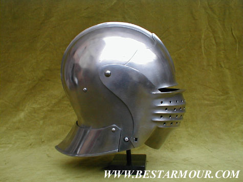

Konstantin Tsvetkov
PostPosted: Tue 14 Dec, 2004 11:31 am    Post subject:         Reply with quote
I am not an expert, just want to share my point of view, but I don't think that we have enough artefacts survived to judge for accuracy any of medieval weapon or armour reproduction, and most of those available are court or parade items. I am sure, that as long as edged and shock weapons dominated on the battlefields, soldiers used whatever they could get of blades and armour, weapons are always in short supply (remember Mosin Nagant rifles in Vietnam and Lee Enfild or even black powders in Afganistan in the second half of last century) and some foot soldier could possibly wear a norman helmet in 1400, who knows. Considering the cost of armour and blades, I don't think that all of any european king's men could afford such a nice and elaborated harness and weapon as examples we could usually find in museums. I think a simple steel spheric helmet was a most common for some 300-400 years. As for style and shape, all of you know, period pictures are not reliable, they just give an idea, and certainly, not all styles and shapes were documented. Really interesting are the pictures of medieval costumes and armour, made in 17-19 centuries, they just had much more material to explore, than we have after Europe was twice devastated by two WW. I have found several interesting and quite unusual pictures of european men-at-arms and jousters in a reprint of such a catalogue. Same for the construction of swords and weapons. Remember the swords with pommels made in a shape of morgenschtern, depicted in Codex Wallerstein part concerning combat in harness.
My point is, that any of modern armourers or sword makers can feel being accurate, producing an effective replica weapon, using period tools and his imagination and commonsense, I mean, those modern "fantasy" blades and armours are out of discussion.
One interesting site I recently found: www.bestarmour.com. There you can find a couple of helmet, looking like the helmet in question.
Please,excuse my bad English and thanks to myArmoury for the SpellCheck facility, it was really helpful.
I have been looking at bestarmour.com for a while and have been considering a purchase. Dose anyone here have any experiences with them that they could share? Good, bad or otherwise?
Their products are a good value for historically styled functional pieces at a very fair price. So much so that their backlog went from four months to a year like every other competent armourer. Sad
A few guys at AEMMA have some of their work. It arrives on schedule and is well finished. Unfortunately the last two helmets received were much too small to be worn. Apparently, the Czechs don't wear padding in their helmets, just mail coifs. Perhaps they don't expect head shots in their style of re-enactment combat? Jeff Hedgecock recently gave us a heads up on that bit of trivia. Now our people clearly specify how to size the helmets including the preferred suspension and padding.
In any case, Best Armour products suit AEMMA's standards for full speed rebated steel combat. I recommend them as a reliable resource for safe harness.
