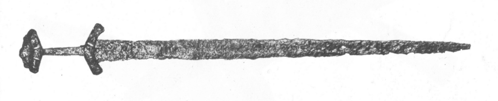

Here's a narrow thick bladed Viking age sword with no apparent fuller found near Adelsö (near Birka).
Link to the Kringla website:
http://www.kringla.nu/kringla/objekt?text=sv%...ect/263029
It seems to me a sword like this would be well suited for thrusting and could be quite rigid.
Hopefully we'll see more tip diversity from the manufacturers in the future.

The photos I just posted, that would be a Maekir then? It almost looks like a sturdy Rapier even.
