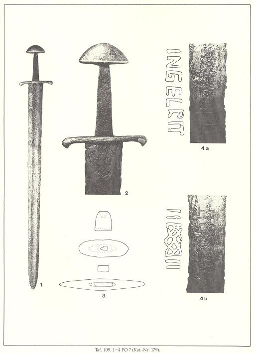

I took a photo of sword Ingerli in Solingenīs museum. Do you know proportions of this sword?
Itīs really nice piece, Iīd like to forge it but unfortunately Klingenmuseum doesnī t respond.
Thanks for your help!

A sword is in Geibig book in scale.

Tim Lison
Posted: Wed 05 Jun, 2013 9:56 pm Post subject: |
Here's a pic for you. Couldn't find dimensions but thought this might help...
Attachment: 47.24 KB
![Untitled.jpg](files/untitled_108.jpg)
Nils Anderssen
Location: Drammen, Norway Joined: 08 Dec 2005
Posts: 61
Posted: Thu 06 Jun, 2013 6:02 am Post subject: |
The last picture is taken from Alfred Geibig's book "Entwicklung des Schwertes im Mittelalter" and they are made to scale. The whole sword is 1:5 and the rest is 1:2. You just got to love those Germans...
The width of the crossguard is 57,8 mm in the book, so about 115,6 in real life
You can then scale the picture acordingly and you will get the rest of the measurements.
I would like to note that the picture of the sword is probably distorted by the camera lense so it is probably not acurate, but should give you an general idea...
When looking at the picture of the sword i almost expected the grip to be longer, but it turned out to be a fairly short bladet vikingsword.
If you do not own that book I can higly recomend it. It has pictures of about 164 swords all done in scale.

Michal Spilka
Location: Czech republic Joined: 06 Mar 2011
Posts: 89
Posted: Thu 06 Jun, 2013 11:57 am Post subject: |
Thank you guys for your help!
Picture with scales thatīs exactly what I wanted. Super!
Itīs really interesting sword, I couldnīt take my eyes off! Beautiful Frankish work.Gold-plated ornament. I think itīs not decorated on other parts. The inscription is well seen on this pic (despite reflection) http://www.nielo-sword.com/foto/in/ . I saw it on another sword too.
Do you know the meaning of INGERLI (ingerlii) inscription?

Posted: Thu 06 Jun, 2013 1:17 pm Post subject: |
It's actually INGELRI, not INGERLI. It is thought that it is a name.
