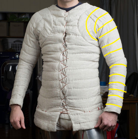

1. Admittedly I just followed the same quilting pattern as the original garment. I don't know how much it would affect the function of the garment, but the historical examples of martial garments from this time period (both extant and in artwork) show a variety of quilting patterns including vertical, horizontal, radial, and a combination of those on the same garment. The actual extant Charles de Blois doublet is a civil garment, not a martial garment. The martial version is generally made from thicker fabric (in my case heavy weight linen on the outside as opposed to the silk of the original), and I've added the series of 16 eyelets around the bottom hem to support a leg harness. The original garment has many integrated points sewn into the lining around the hem to support the wearing of hosen.

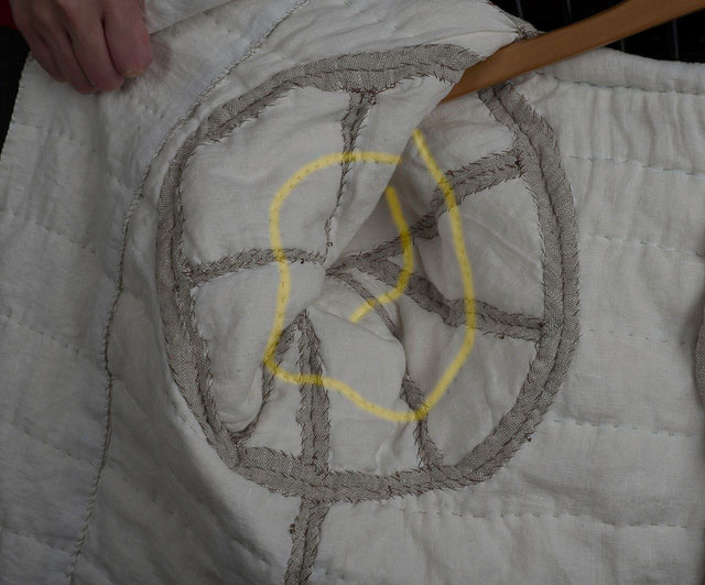

2. The upper sleeves are fully quilted. The pattern of the quilting goes around the upper arm along the circumference like lines of lattitude, so it makes no difference that all the gores are there. The gores basically turn the upper arm into a giant circle. The quilting lines then run around the circumference of the wrist all the way up to and including the armpit. I attached photos from the 2015 version of the garment below that highlights the quilting stitches as viewed from the outside, and from inside of the arm hole. They look irregular from the inside because the sleeve is not supported and is folded on itself, but they're really just following the circumference of the sleeve.
3. Because the garment is thick the pre-bend at the elbow is nice because you don't have to fight the natural lay of the fabric to bend your arms. As a martial garment this has an added benefit because your arms are almost always going to be bent in the context of fighting.
Attachment: 62.86 KB
Arm quilting pattern from the inside
Attachment: 67.16 KB
Arm quilting pattern from the outside
