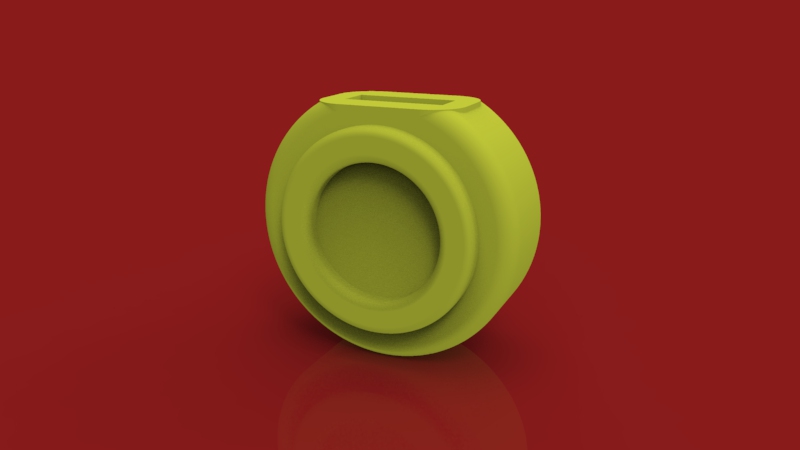

Solidworks is the best program for CAD. it can be found on "certain websites" that are swashbuckling related for "less" than the list price.
it is what I use in my engineering program and allows you to make editable, dimensioned parts.
for generating millpaths, you can use either solidcam, an add on to solidworks, or Mastercam- a standalone program that also does 3D modeling, but is much clunkier for designing parts and they are not dimensioned like the solids in a .sldwrks part
 Attachment: 40.72 KB
