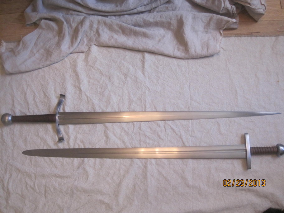

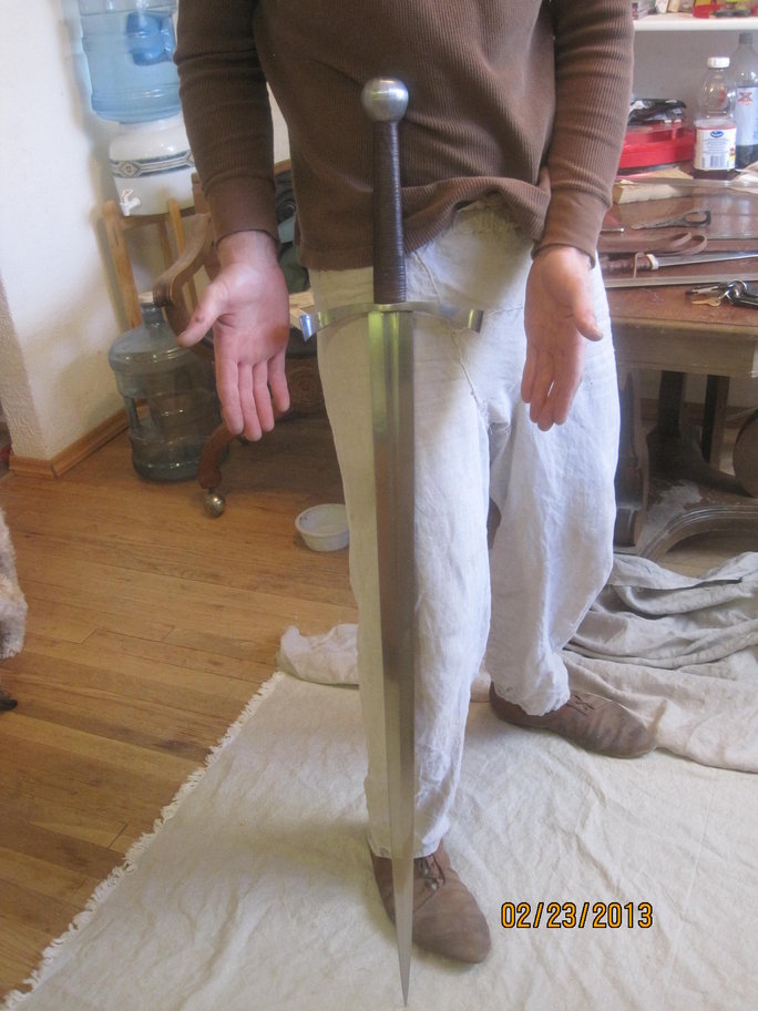

Welcome to myArmoury. Albion's type XVI blade blank would be an excellent basis for a Game of Thrones sword. I have been rolling the same idea around myself, for fantasy swords the GoT swords look really good. I especially like the sword of Brienne of Tarth myself. The Hanwei Tinker GSOW's blade is really nice too, if you want a less tapered blade and longer fuller. Here are some pics of my own beginning projects with the Albion XVI and the GSOW.

Ryan, it is just a standard bare blade blank. The profile has indeed been changed quite a bit, with the the base narrowed very slightly and the point made very pointy. I tried to get as much convexity to the edge as I could, while the blank came with very straight edges tapering to an ogival point about 3/4" wide. As the blank comes, the shape is much more similar to the GoT blades.
