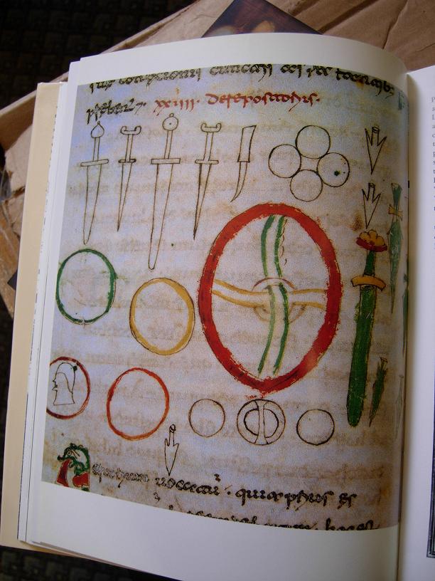

I'm trying to find examples of quillon daggers from the 11th to the 14th centuries. Historical examples seem to be as rare as hen's teeth. Below is what I've found so far. Has anyone got any others?
 Attachment: 70.17 KB
A picture uploaded to myArmoury (from Chris Poor I think?)

PostPosted: Tue 11 Sep, 2012 5:13 am    Post subject:         Reply with quote
Here's a thread on 11th century daggers in general, which is where you got 2 of your images: http://www.myArmoury.com/talk/viewtopic.php?t=11375 .

It seems that in 11th and 12th century daggers weren't yet popular, or at least got 'missed' in sources, because we don't have that much about them. Though there are still some traces.
This is from Barcelona and dated to around 1120, it seems.

PostPosted: Sat 15 Sep, 2012 8:35 pm    Post subject:         Reply with quote
Here's a colour pic of one of the daggers from the first picture posted:
X.4 Dagger, late 14th. century (Royal Armouries Leeds UK)
