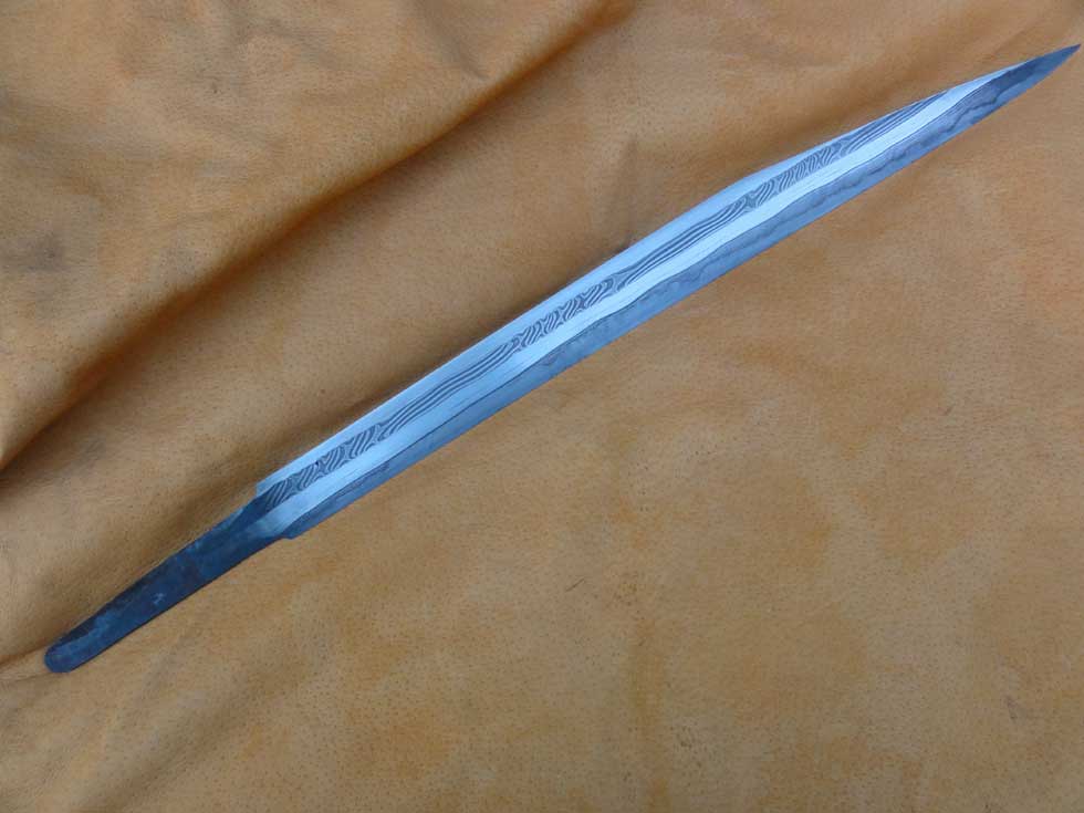

i have a long patternwelded seax in the making so i thought i would post pictures from the process
i learned not to be attached to blade until heat treat is done, so no pictures before that step now

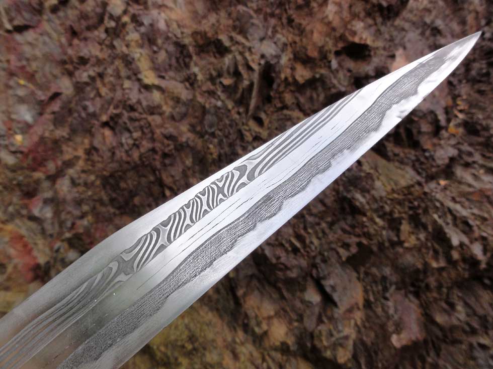

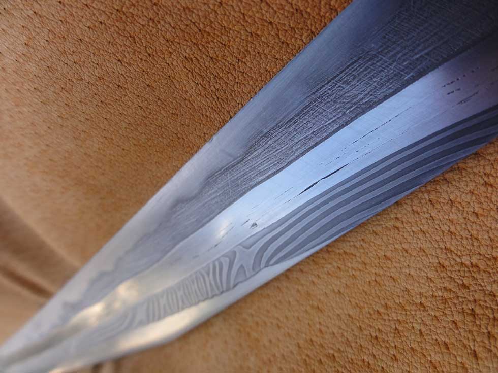

here is the blade after etch. its four bars construction
wrought iron nack, then 9 layers interupted twist. wrought iron and then steel with spontaneously formed hamon

then some more polish and oxide removing

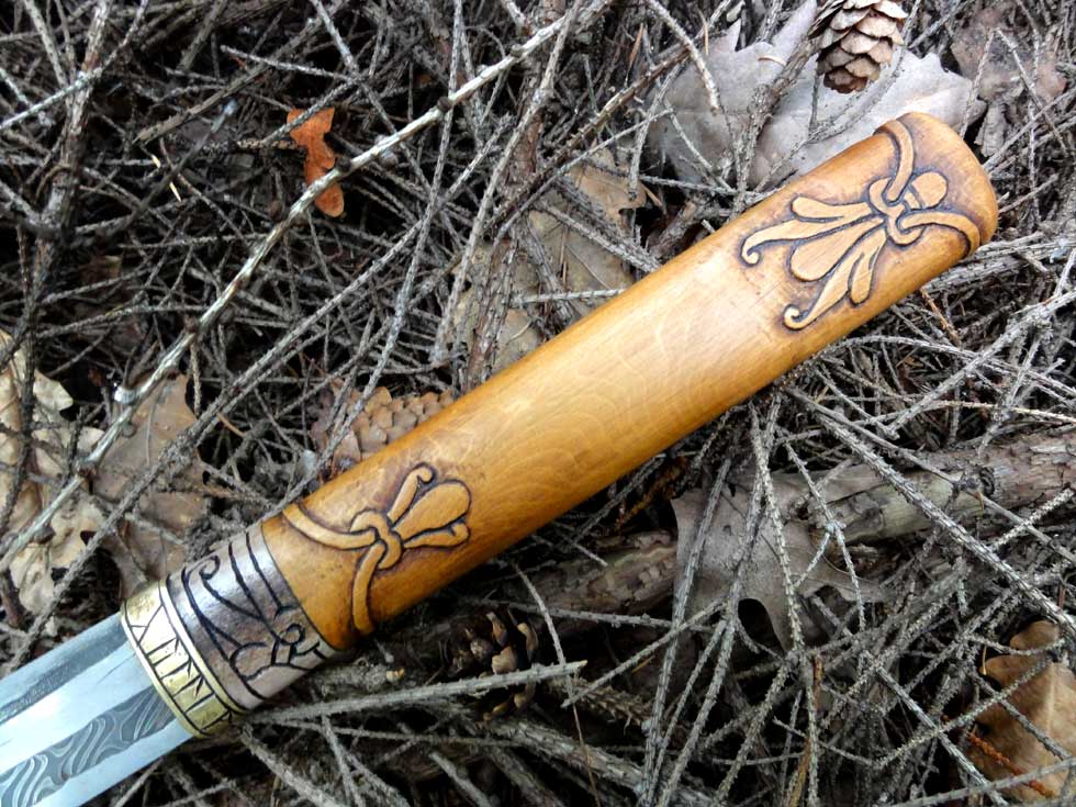

handle is started, the runes on the ring say GULLI ME THORTE, traditional sentence Gulli made me

and then carving in angloscandinavian form of ringerike style. Motives taken from English finds

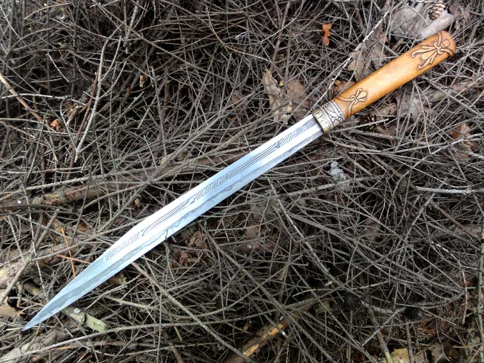

the lenght of the blade is 49 cm and over all lenght is around 70 cm
(will meassure as soon as scabbard leather dries out

I agree and each pic viewed in sequence was better and better: The blade looks rich in contrasting pattern and textures.
What type of wood did you use for the handle ? Just curious as it has a nice warm feel.

its lightly stained boxwood

very nice work love the carvings and the iron between the twist and the edge gives a beautiful look to the blade

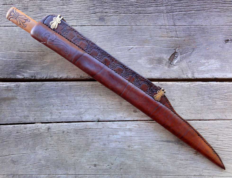

Hello! i made a big progress on the sheath

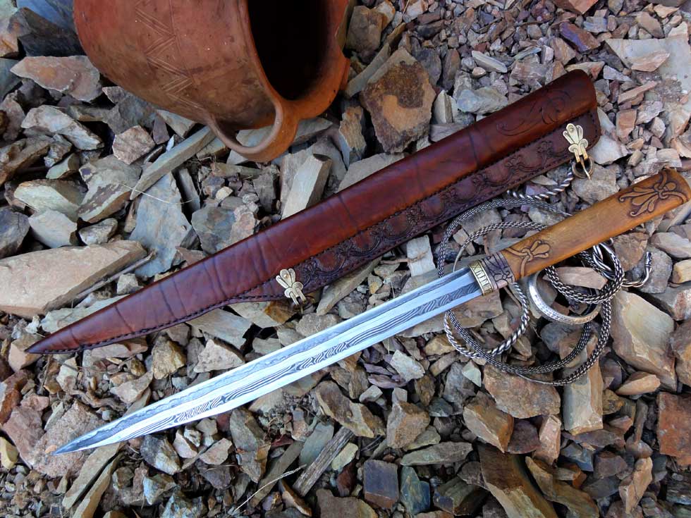

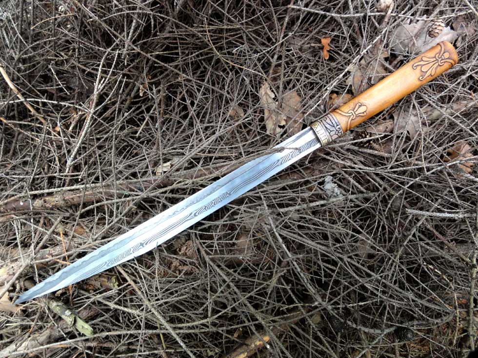

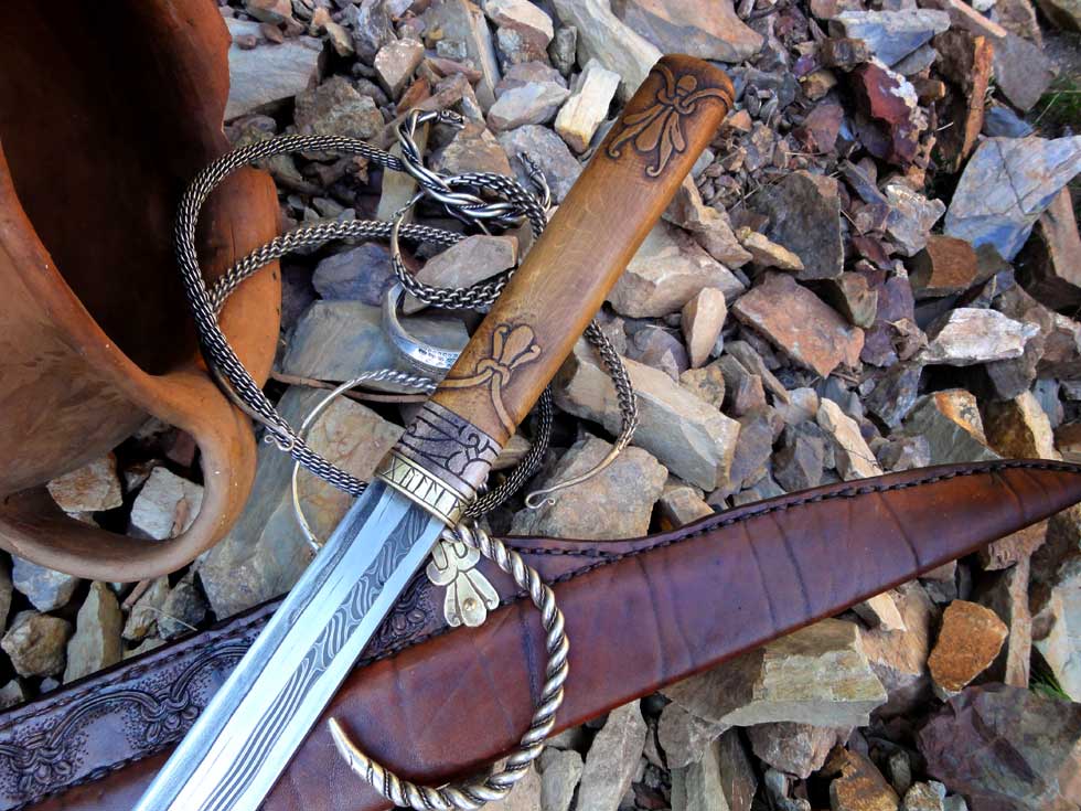

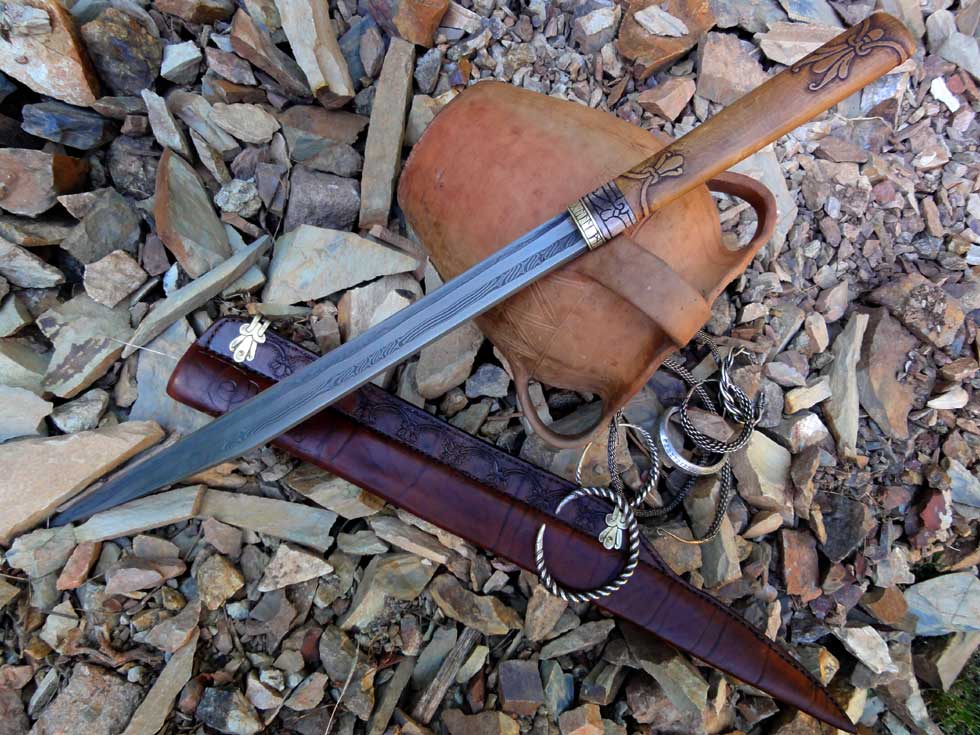

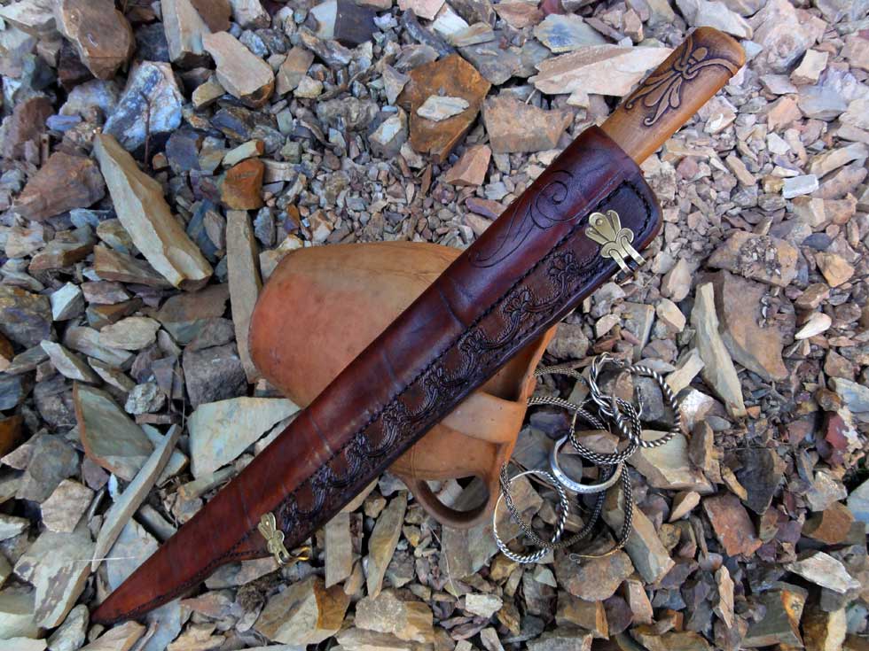

Hello!
Finished this one, here are the pictures:
your comments are most welcome as always

The OAL is 70 cm exactly, the blade being 49 cm.

Petr,
Your new blade is outstanding, but I am always impressed by your carving and leather work.
