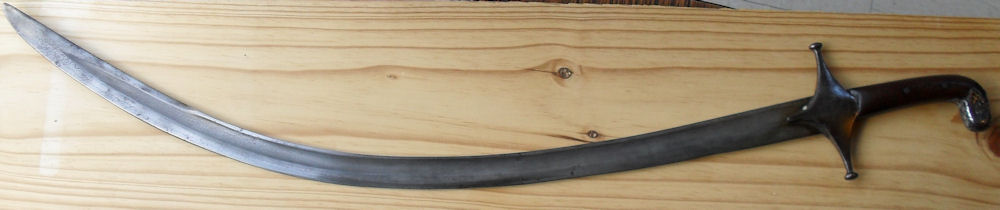

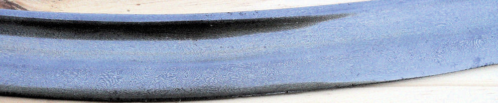

Posted: Sat 07 Jul, 2012 9:50 am Post subject: |
I'm not sure to which period or even culture you are referring, but the short answer is going to be 'yes'.
Discounting mere lamination, most examples of an actual deliberate pattern will have been etched to one extent or another to make them visible.
If you think of the traditional pattern welding seen in European blades right back to the classical period, then you should be thinking along the lines of what the Ottomans were doing with their blades. There is no way that a smith is going to make (for instance) a double row twistcore 'starry night' pattern with diferentially hardened steel cutting edges and then not bother to make it visible (see first and second pic below).
Here is some food for thought:
http://www.vikingsword.com/serpent.html
Even in wootz blades from asia, while a simple 'crystaline' wootz blade may or may not have been etched, it would be illogical for a smith to manipulate the particles of hard impurities while forging the wootz ingot, into complex and deliberate patterns only to leave those patterns invisible to the naked eye.
It takes a LOT of effort to manipulate a wootz ingot into a fine flowing pattern with ladders or swirls etc. If you want your holy warriors to appreciate this efort, to contemplate it's beauty and reflect on the "forty steps" upon which the faithful ascend to Heaven, or imagine the rivers of paradise in it's 'watered' flowing patterns.....
I'm sure you get the picture
Have a look at pictures 3 and 4 below and imagine how much effort it took to put that pattern in my Shamshir.

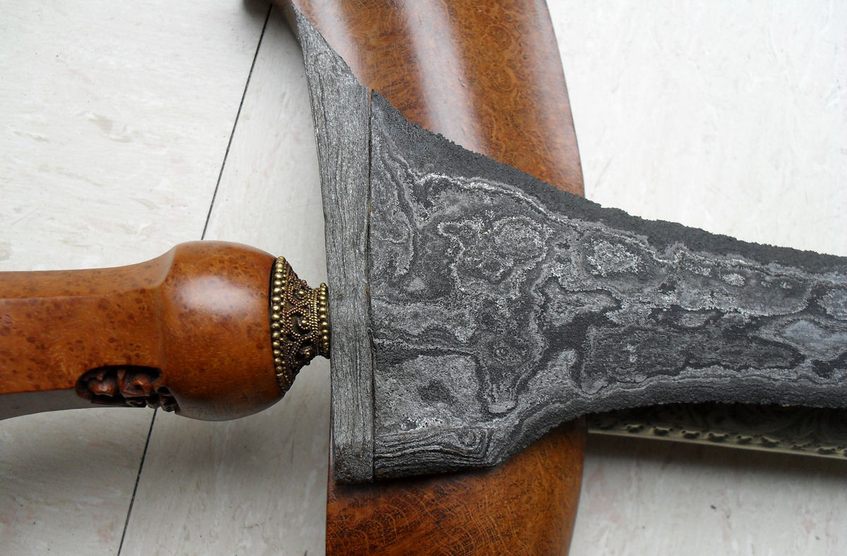

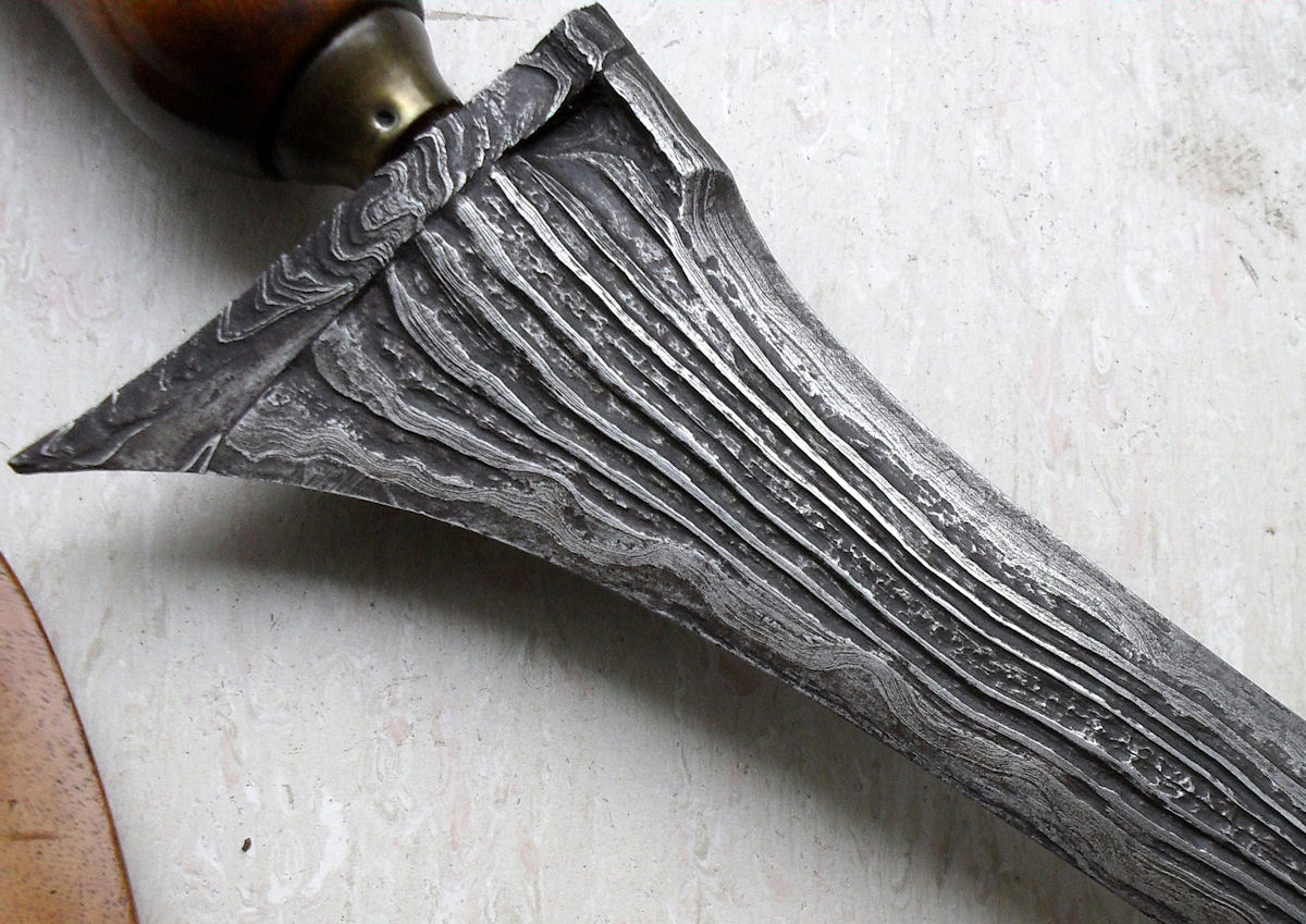

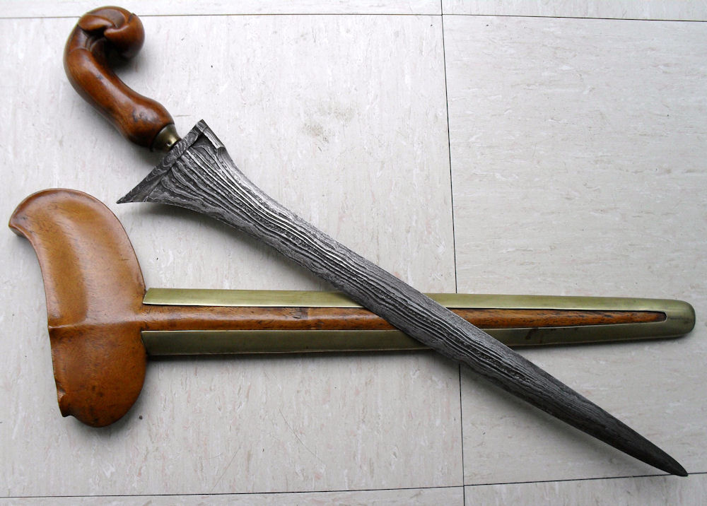

Posted: Sat 07 Jul, 2012 9:56 am Post subject: |
In some cultures of course the patterns produced by pattern welding are of as much or more importance than any other 'feature' of form or function.
Think about the 'pamor' of the Keris. In these it is possible to see how far the patterns can be etched and stained to produce the highest possible contrast.:

Posted: Sat 07 Jul, 2012 10:03 am Post subject: |
In this Keris, the combination of skilled forging, etching, polish and stain all combine to produce a '3d' relief effect that means that even on a blade which may be pre-1800 the pattern 'pamor' is still beautiful and clear long after most of the final staining has faded:
