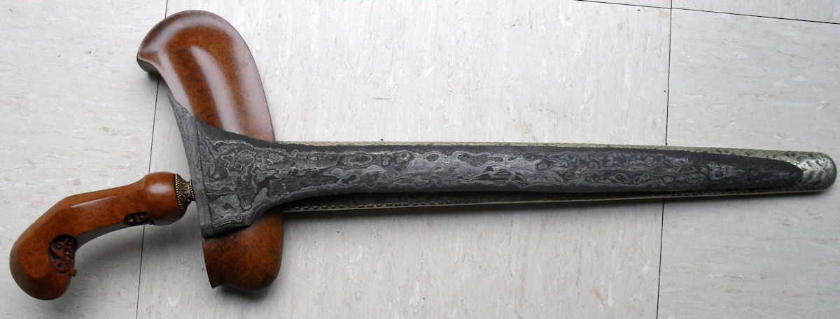

In some cultures of course the patterns produced by pattern welding are of as much or more importance than any other 'feature' of form or function.
Think about the 'pamor' of the Keris. In these it is possible to see how far the patterns can be etched and stained to produce the highest possible contrast.:
 Attachment: 197.52 KB
 Attachment: 95.22 KB
Gene W
Location: The South Of England
Joined: 01 Dec 2010
Posts: 116
PostPosted: Sat 07 Jul, 2012 11:03 am    Post subject:         Reply with quote
In this Keris, the combination of skilled forging, etching, polish and stain all combine to produce a '3d' relief effect that means that even on a blade which may be pre-1800 the pattern 'pamor' is still beautiful and clear long after most of the final staining has faded:
 Attachment: 230.47 KB
 Attachment: 128.3 KB
