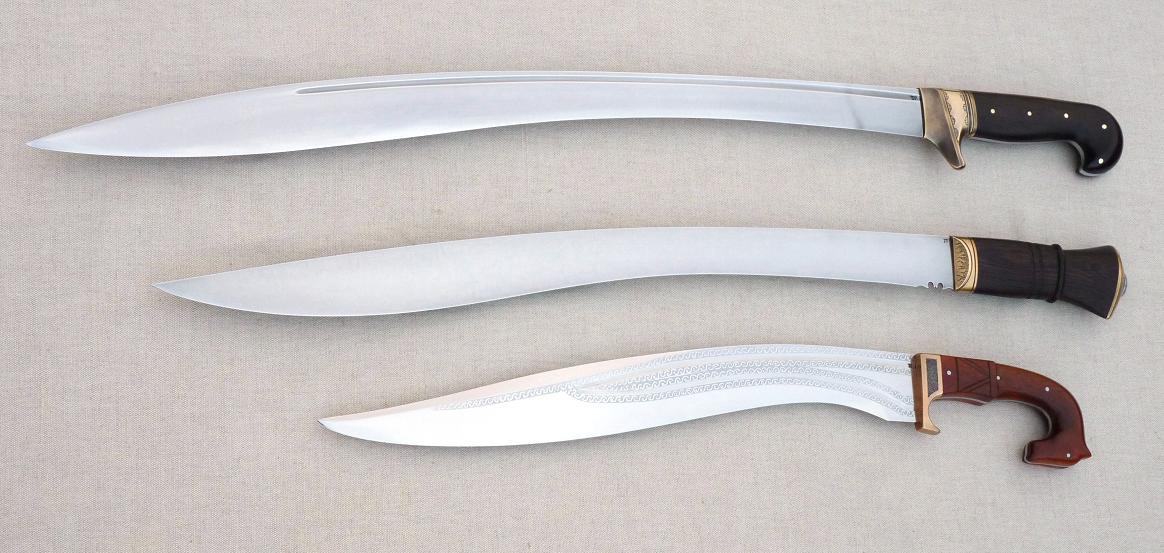

The first one is a somewhat modified version of the kopis in the Etruscan museum in Rome. Unlike the original this has a powerful convex ground blade and a guard made of brass, otherwise the hilt has the typical full-tang construction with ebony slabs fixed in place by brass pins. I made the hilt rather 3-d in shape, but not quite so drastic as the later yataghans.
Overall length of the sword is 74cm, length of the blade 59cm, weight 1,054kg and point of balance is 14,3cm from the guard.
The second one is my version of a “battle-kukri”, it is loosely based on an original I was able to study last summer and on some pictorial material. The blade is forged from high carbon steel and has been etched so that a wootz-kind of pattern shows on the surface – the pattern is so neat that I decided to leave all fullers & such off of the blade. The hilt is of brass and wenge with some decoration on all parts. The decorative ridge on the grip is actually very necessary when swinging the sword, as it locks the hilt firmly into the users hand. I made an ugly but sturdy sheath for this one using lined moose leather…
The overall length of the kukri is 66cm, length of the blade 52,5cm, blade thickness 8mm, weight 0,835kg, pob. is 14,3 from the guard.
Third sword is one of those things that I have grown to love – a falcata. I think that I managed to put quite a few of the neat characteristics of the historical swords into this one. It is very light and Very Fast cutter, with the point nice an low for stabbing. The curved fullers were rather difficult to make, but what would a falcata be without fullers? The etched decorations around the fullers were something that just had to be tried. The blade is forged from 0,75% carbon steel, the hilt is of bronze and hardwood. The sword has a double-layered leather scabbard with simple brass suspension rings.
Overall length is 51,5cm, blade 39,5, weight 0,608kg and point of balance 8cm from the guard.
I was able to do some test cutting with the falcata and also try out the battle-kukri blade before it was hafted. The falcata is so light and fast that it goes through the mats like they event weren’t there. The shape of the hilt makes it very safe and ergonomic to use – you simply cannot drop it! The kukri blade was a scary one, reverse backhand cuts that usually lift the mat from its stand went cleanly trough…
These three ones are on the free market, so anybody interested please let me know. It will be a while before I can make this sort of weapons again…

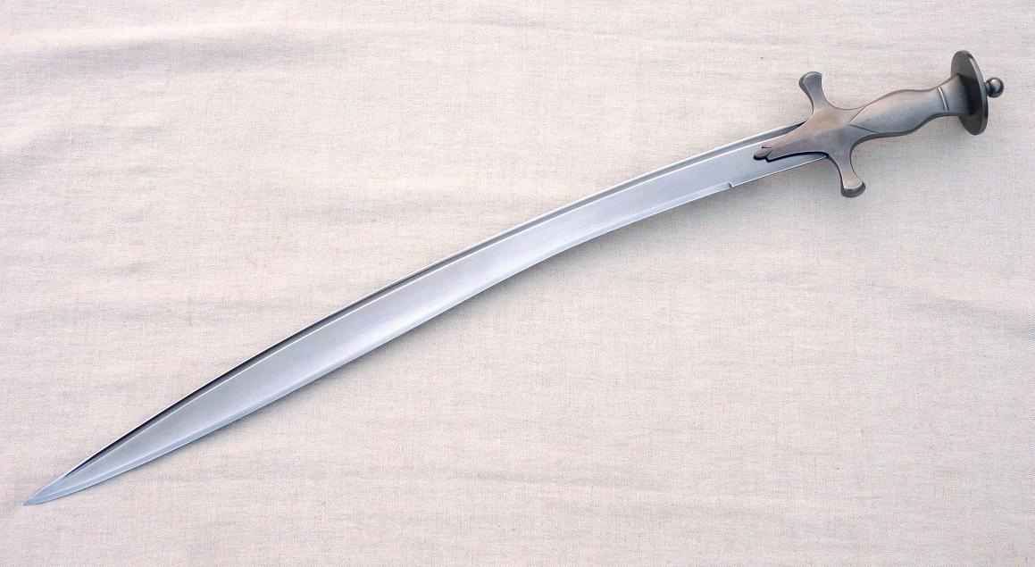

In a way, the three earlier swords lead the way to the fourth one – which is an Indian sosun pattah-sword with mogul-style hilt. The sword is a custom order that I took on as I have wanted to make such a piece for so long.
The blade is one of the most demanding ones I have made so far – T-cross section alone is a bit tricky to make- the forward curve of the blade makes it somewhat more trickier. It is forged from the same high-carbon steel as the kukri, but with finer hand finish and with the pattern showing in a more subtle way.
The hilt is all damascus steel, forgewelded to shape. The actual hilt is formed from four parts forgewelded together with a channel for the tang in the middle. The disk pommel, “pommel-cup” and the finial knob are separate pieces, also of damascus steel. There is very little extra decoration on the hilt, somehow I felt it did not need it… I am still considering of doing an etched decoration on the blade close to the hilt though.
The dimensions of the sword follow historical swords quite closely, but the hilt is somewhat larger to accommodate an european-sized hand. Mainly due to this, the sword is somewhat heavier than the originals.
The overall length of the sosun pattah is 81,3cm, blade length is 66,6cm, weight 1,285kg and point of balance 13 cm from the root of the hilt.

I must confess that for me the sosun pattah is maybe the sexiest sword type there is, -the curves, the T-rib blade, everything…
-On technical side, the hilt was quite a challenge to make. As I mentioned above the hilt is formed of four pieces forgewelded together. In practice it means that the two L-shaped parts that form the front and the back of the hilt and the guards were shaped to fit precisely on both sides of the tang. The long flat sides that also form the langets were then forgewelded on both sides of the L-shaped parts without deforming the channel inside – a very delicate weld to make, but in the end I did not have to file the tang or the insides of the hilt afterwards, the parts fitted together just so.
The original all-steel tulwar hilts have usually pre-shaped parts soldered together, but I just felt that I had a better chance of success by forgewelding the parts together. After the weld, there was quite a lot of anxious grinding to do – basically I was thinning out the walls of a tube – never knowing when the sanding belt or a file would go finally through and ruin the whole piece…
