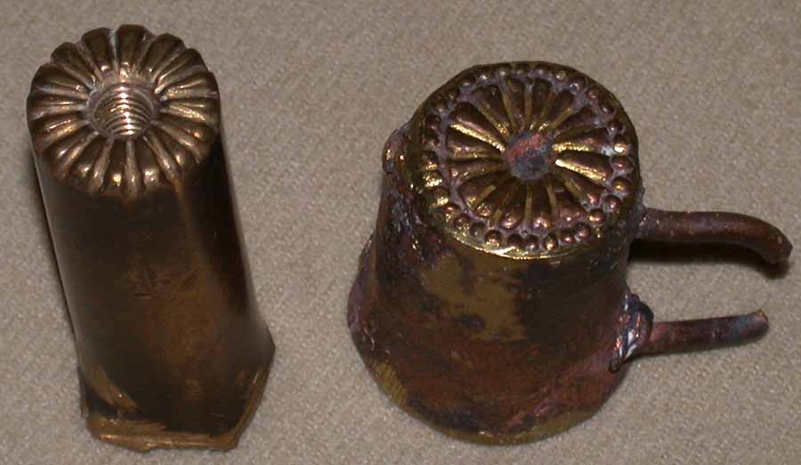

Oh, here's a photo of the Roman rosettes I make, along with the tools:
http://www.larp.com/legioxx/dies2.jpg
On the left is my current die, cast from brass by a friend of mine. At top is my original die, just a piece of brass rod (from a door handle) with the end rounded and grooves filed across. For that I first stamped the blank with the ring to get a nice raised edge, then the floral die. The old die was used to make the mockup for the new one, and I added the pearled rim. At right is a 1" leather punch used to punch out the brass discs. After a few rounds of stamping discs, the lead slab gets too badly marred or starts to break up, and I just remelt it.
Aha! Old die and new die:
http://www.larp.com/legioxx/dies1.jpg
