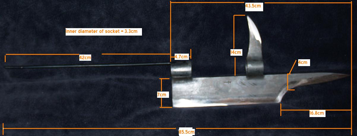

Victor R.
Location: Klein, Texas
Joined: 28 Jan 2008
Reading list: 4 books
Posts: 373
PostPosted: Tue 20 Dec, 2011 9:07 pm    Post subject:         Reply with quote
It isn't very pretty, but I took a picture of my halberd head and used the paint program to enter in some of the more pertinent dimensions. Hope this helps!
Edit: Still haven't learned the secret of getting the pictures to show when I attach (copy/paste, maybe?)...
 Attachment: 73.08 KB
