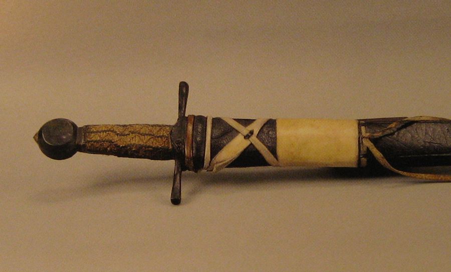

The scabbards used for most swords across Europe throughout a majority of the 13th century had the typical tied-belt suspension, much like a lot of the reproductions you'll see around here had. As far as we know, based on surviving scabbards, there was very little decoration either on the scabbards or suspension belts at this time.
Attached are images of two Spanish scabbards, with dates and owners tagged in the image script. These are better surviving examples, but are later than what you're curious about. The main difference you'd expect earlier in the century is simpler sorts of belt suspension, possibly just looping and stitching two separate belt components in either direction, without any of the fancy tying, etc.
