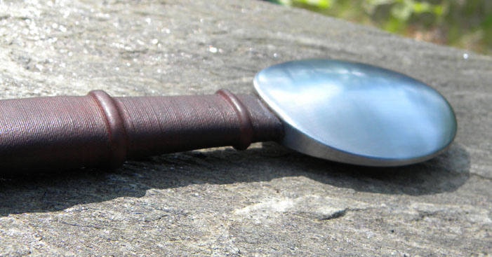

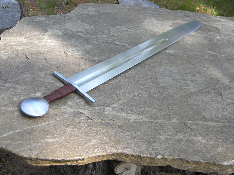

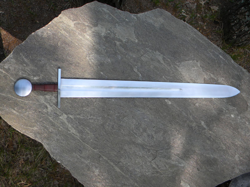

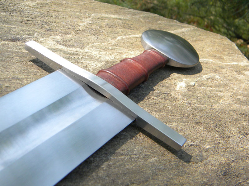

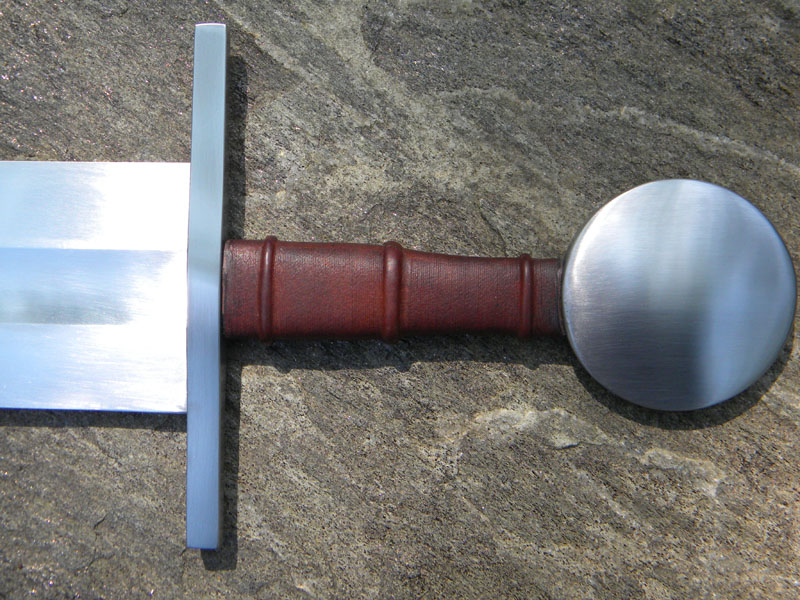

A while ago a thread was started showing the debut of a sword not see before, only drawn. Somehow the drawing didn't catch my eye while looking through Records, but the image triggered my creative drive and produced a sister sword that I feel is pretty good tribute to the original. For those that missed the thread it is a worth while read! http://www.myArmoury.com/talk/viewtopic.php?t=22559
Without any further chatter I'd like to share some specs and images
Length overall: 38.3"
Blade length: 32.2"
Blade width at guard: 3"
Blade width 5" from tip: 2.3"
Weight: 2lb 8oz (1.159kg)
Point of Balance: 5.3" forward of guard
The blade feels super light, very fast, and has excellent control, but has enough mass to do what the original was probably designed to do. I actually had to make the blade twice. The first one was coming together really well, I got the fitting roughed in and realized that the fuller was slightly off, so I went back to correct the issue and ended up grinding through, oops! It was a wonderful learning experience though, and made a second blade to match the fittings. I gave this blade a utilitarian finish for easy clean up after test cutting or drilling.

That is one heck of a sword! It looks like it would be a terror on lightly armoured and unarmoured opponents.
The finish is very nice too.

That pommel is really cool. I don't believe I have ever seen its like before...

How cow!!! Now that's a wide blade!!!
I really like this one!

I'm lovin' this photo:
Imagine seeing that come up to you on a field! Holy crap.

I really like the shaping of the disc pommel. Have you and/or other folks seen this type of shaping on period examples? It's a nice departure from the typical disc pommels with a consistent thickness.

The blade must be nice & thin to be of those proportions and yet weigh well under 3lb's

That's a lovely sword with a unique profile and an interesting pommel. What is the blade thickness? probably much thinner than the average medievel blade?

At Roger, thickness at what point? I have documented one sword, a XIV that had a similar thickness at the guard, and at the tip, so I know my thickness are plausible. I was also able to find out the weight of the original and mine is in the neighborhood of around 50 or so grams more heavy, but the original has corrosion and no grip so...
At Peter, Thank you! There are a few things I would like to do different for when I revisit this sword again and I'm hoping that the changes will help iron out some details. Ohh the details. Plus the next one I want to do a much finer finish on Happy Hopefully this one doesn't sell so I can bring it out to Ashokan.
At Scott, I agree that the grip is a little bit longer then the original, but only by less then .2" so it isn't that far off. This blade is a little bit shorter, and wider then the original, but I kept the guard about the same width, and the pommel a little larger to match the blade thickness so there is a little bit of visual unbalance. This didn't really pop out until I had the woodcore on the handle and the fittings set and cleaned up so I decided to run with it. Happy
At Paul, the blade is super thin, especially at the tip, but it is certainly not flimsy. The width of the blade adds a lot of stability.
At Jeremy, the pommel is kind of my interpretation of the original from the angle shot in the original thread. I went into Photoshop and I lighten the image and increased the contrast and I found that the pommel was a little wider where it met the grip, and then slightly tapered. It is hard to tell from the images exactly what the pommels surface is profiled like but I took some artistic license and combined the info I knew with some time at the grinder and figured out what looked and felt right Happy

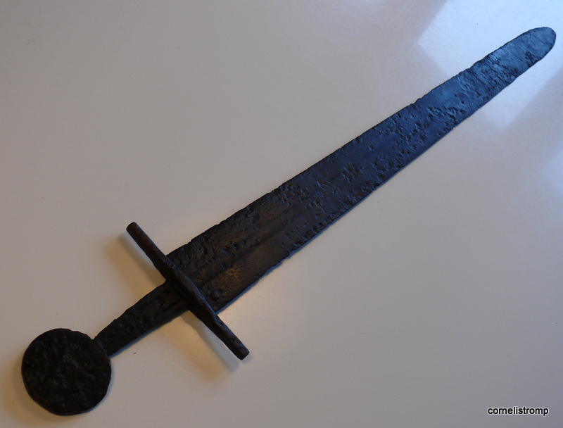

Hi Michael,
I am the owner of the Original and I am POSITIVE amazed by your great achievement. so must the sword have been like 800 years ago.It looks heavy and solid but actually is very swift and feels light in the hand.
I'm not normally not so interested in subsequent reproductions but I realize that your skill to make this masterpiece has changed it drastically. I know how thin the blade must be to achieve this weight.
This type of broad XIIIb is along with the 2 centuries later and probably out of this type further developed typeXVIIIC the most effective and efficient cutting sword there is.
absolutely great performance! your sword is unique and desirable.

Now here is something that leaves wondering...and a bit envious too. Any other treasures such as this one you'd be willing to share with us Cornelis? Happy More shots of this one would be great too!

Thank you once again for the comments and thoughts, and it is a pleasure to have you chime in Jasper. The shot of the original shows that I put a little too much curve in the surface of the pommel, a detail to be corrected next time.
