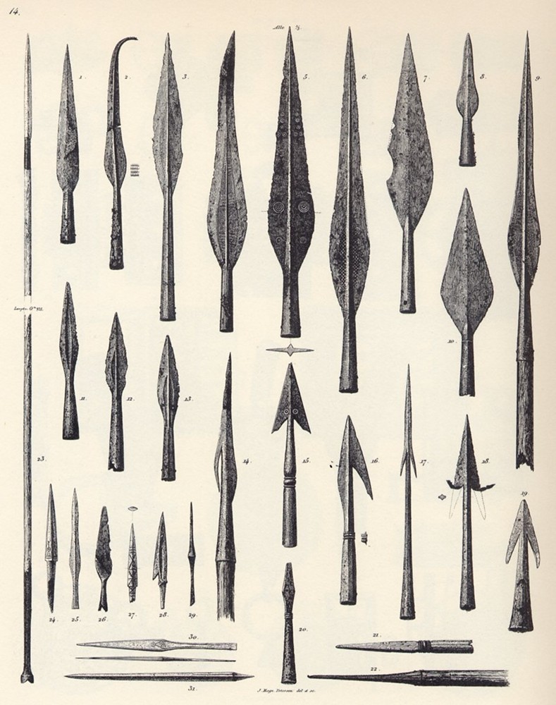

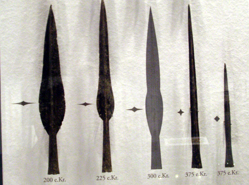

Ok, now the pictures:
The first one shows a lance head from a grave find dating very close to the beginning of period B1a. The picture is taken from "The spoils of victory: the North in the shadow of the Roman Empire".
Notice that the central rip is not in place yet.
The second one is the one from Engelhardts book. Just drawings, but really detailed.
It shows various types of lances and spears with different datings, but you notice the similarities, like the mentioned central rip and the really small socket.

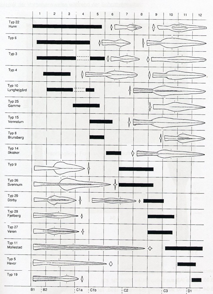

The third one shows different types of spear/lance-heads and how they date.
Most interesting for you should be the first half of square one, that is period B1a.
The picture was taken from a book by Jørgen Ilkjaer "Illerup Ådal Band 2. Die Lanzen und Speere.". Also a nice book to have, but the expense might be a little to much for the average reenactor.
