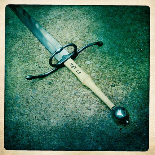

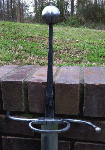

Here's an idea I've been kicking around since I almost accidentally acquired the guard of an old Windlass "German Backsword".
I looked at this guard for a long time and found too much wrong with it to salvage it as that particular type of late 16th c. guard. I attacked it with a Dremel tool to remove everything but the side ring. Looking at it that way I decided it could be used to create a longsword in the German style of ca. 1520. Those typically have a pommel of Oakeshott style T, often writhen. I have art historical evidence for what Peter Johnsson has described as a peeled orange or clementine matched to this type of guard on a longsword. I also have art historical evidence for plain spherical pommels in this period. I'm not sure I've seen a plain spherical pommel on a longsword with this type of guard in this period. Diagonally-filed semi-spherical pommels like that on the A&A German Bastard Sword inspiration below also seem to have been common.
Just to prove the concept I put the rough-cut and otherwise untouched guard on an A&A Dürer blade and tossed in an Alchem pommel, which I correctly guessed would provide a reasonable counterweight. The grip is just a placeholder--the leftovers of an earlier Dürer project. I wouldn't use that type for this project. The result, without any other manipulation feels great and doesn't look half-bad.
So, I'm thinking that this project could work with:
• Refinement of the guard, include a stronger re-curve of the quillons, reshaping of the terminals (to spherical, maybe filed) and either a flattening of the inside of the side ring or at least a reshaping of that central swelling (again, to spherical, maybe filed). Bright or black finish would be fine for this sword. Typical of Windlass guards, it needs LOTS of material removed.
• Refinement of the pommel. I'd create a foot, which would give the pommel more of the clementine shape but not quite that pronounced. I'd like to try the peeled-orange facets but I'm a bit nervous about that. These pommels are about $13, though, so it's not as if I'm sunk if I screw it up. I'd create a decorative washer and nut for the top of the pommel.
• The blade is perfect as-is but I might have to take a small amount of the top to get the hilt proportions right. Not sure about that yet.
• Ignore the placeholder grip. The general shape is ok but I'll need something a bit more robust. My initial thinking is that these swords look great with all-black hilts and that was a common treatment in the period.
This might be my next project, depending on how quickly all of the pieces come together in my understanding. I wanted to just throw it out here as I ponder the possibilities. As always, I welcome critique, comments and suggestions. Big Grin

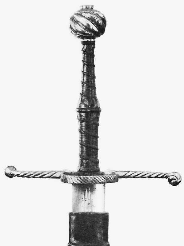

Hi Sean, as another fan of this type, I'm also looking forward to seeing how this turns out!
One thing I find interesting about this type is that, while the pommel and terminals/finials don't always 'match' in shape, decoration, etc, there's often still a sense of harmony across the whole hilt that is often quite pleasing. I'll be interested to see your rendition of this!
I was also interested to see the highlights on the grip's cordwrapping in the first image you posted. I'm not sure I've seen any modern repros that feature this ... something new to try? Happy

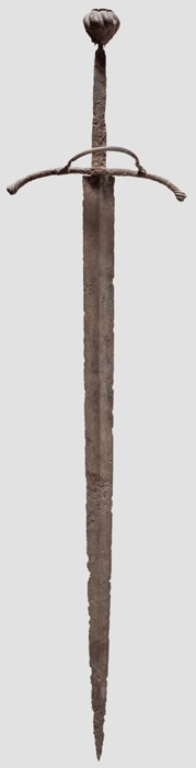

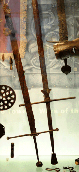

Seeing this sword of ca. 1500 at the Museum of London rekindled my interest in this project. I still keep thinking about a backsword blade, but when I pick up my experimental assemblage it really impresses me with its balance and proportions.
 Attachment: 110.06 KB

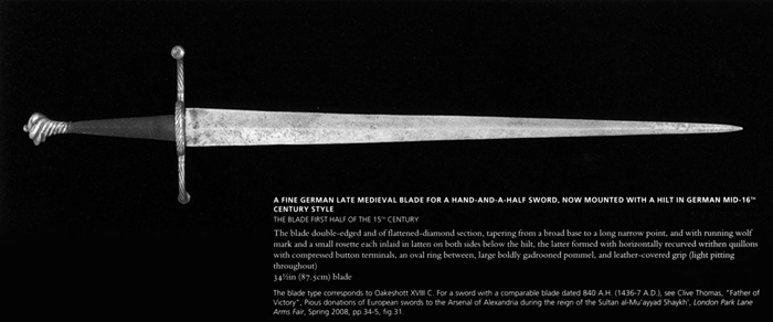

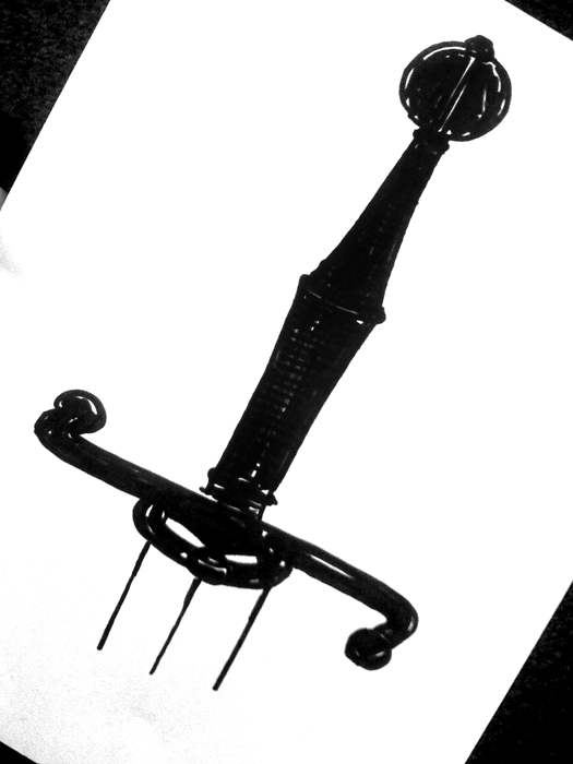

A quick sketch of the direction I'd go with this one.
 Attachment: 68.32 KB

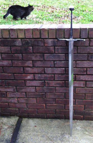

PostPosted: Tue 01 Nov, 2011 8:35 am    Post subject:         Reply with quote
A better view of the proportions:
 Attachment: 215.81 KB

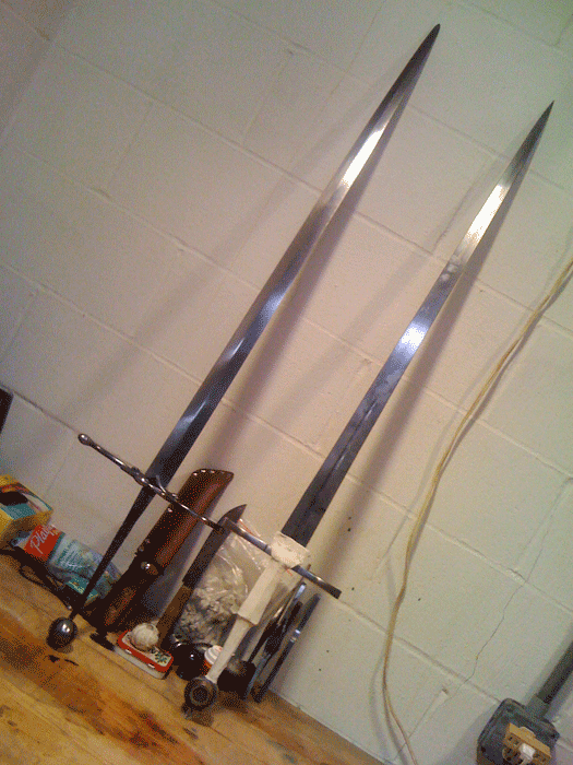

progress on the guard. Still some stock removal left around the block and terminals, but the re-curving and most of the rough shaping is done. At a guess, I'd say I've removed about 25 percent of the original hilt. Big Grin
 Attachment: 216.52 KB

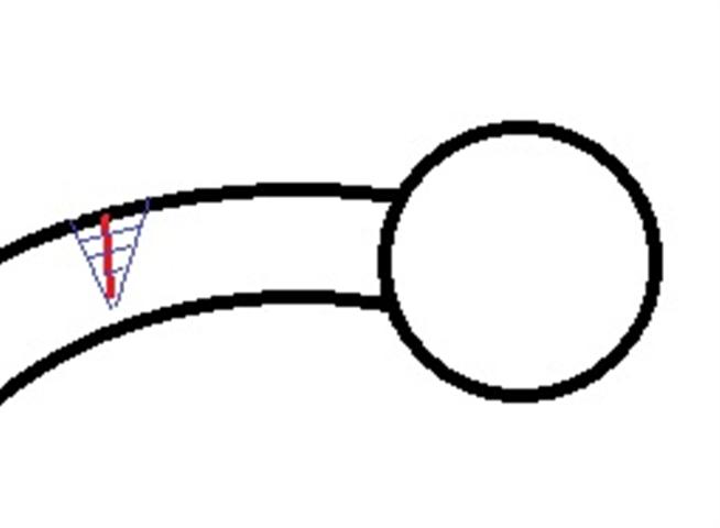

finished the lobed pommel, turned back to the guard and noticed a crack at the base of a quillon. applied some force and was able to open it. crack extends about 2/3 the way through the steel. filled it with jbweld, closed and clamped it. if it doesn't hold, game over Sad

PostPosted: Mon 06 Feb, 2012 4:39 am    Post subject:         Reply with quote
Why not have it welded up? It seems you have a bunch of time in this project and welding's not that expensive. Just a thought.

PostPosted: Mon 06 Feb, 2012 6:05 am    Post subject:         Reply with quote
Sean Flynt wrote:
it's certainly worth a try because this thing was shaping up to be a beautiful piece. i know a guy...
Yeah that's your best option and would take about 5 min to weld. You might want to prepare the area with a dremel first, taking off the cracked area in a bevel as below. Once filled with weld you'll end up with something as strong as before.

PostPosted: Mon 06 Feb, 2012 6:56 am    Post subject:         Reply with quote
Thanks for that diagram! I'll take that with me when I talk to my university colleague/hobbyist welder.

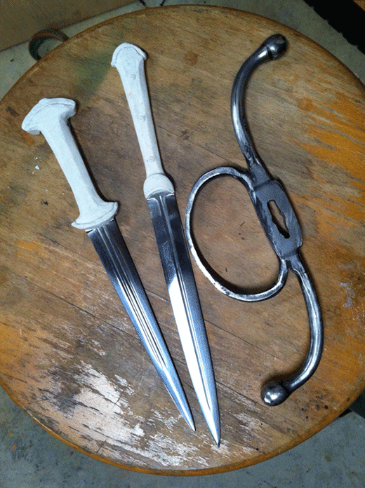

A couple of phone shots of the progress. It's hard to see the pommel here, but it's four-lobed and without a foot. There might be a couple of areas to clean up with a file, but it's mostly ready for polishing. I'm just getting started on the guard terminals and still have lots of work to do everywhere. But at least I'll be able to save it! The cat is for scale Big Grin .
 Attachment: 102.91 KB
 Attachment: 95.64 KB

PostPosted: Mon 06 Feb, 2012 1:52 pm    Post subject:         Reply with quote
This is looking great Sean, the proportions are really nice and pleasing to the eye.
Remind me what blade you've used? A windlass? a tinker Hanwei? I'm puzzled by the length of the tang.
I take you've seen peter Johnsson messer video...want to give a go at some quillons roping?
Interesting pommel, hollow for sure given its size (mind you the tang extends so far I'm starting to doubt...). Will you top it with a flat flowery bolt for the peen?
And finally, this calls for a slender tool grip! That rules out chamois doesn't it? Happy
edit: I also like what you have in mind for these bare dagger blades. Will you grind of the raised parts at the ricasso area?
PostPosted: Mon 06 Feb, 2012 2:00 pm    Post subject:         Reply with quote
Interesting pommel, hollow for sure given its size. Will you top it with a flat flowery bolt for the peen?
That's an A&A Dürer blade.
Thought about roping. Not especially difficult, but there are plain examples as well. I'm not sure how I'd like it with this less complex pommel.
The pommel isn't hollow but it balances the blade very well. There's probably some perspective distortion here that might make the pommel look larger than it is. But with the 48" Type XVIII blade, it needs significant mass.
The grip will be waisted, for sure. Haven't chosen the exact form, though. I'll look into some thin calf because I'll need some for two other projects in the works.
On those daggers--yeah, I'll probably modify the tops of those blades in some way.
