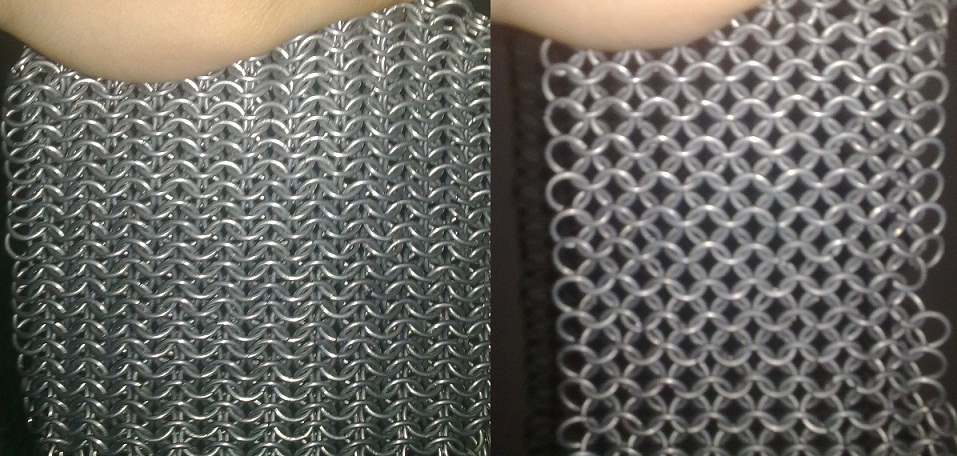

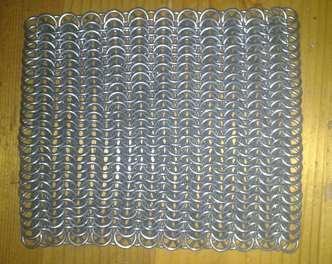

About 6 in 1 pattern: I was recently trying this pattern and i was surprised by its thickness and flexibility, thats why i was asking question about historical evidences of this pattern because Im thinking about making the whole shirt from it. Here are photos of what i did (those are only butted rings) and comparison with 4 in 1 pattern. (sorry for mobile phone quality:/)
Dan: would you please post picture of that 6 in 1 haubergeon? Im really curious how it looks like when its done.

Diameter was c.10mm. Wire was 0.8-0.9mm. I made it from butted links. I wasn't interested in historical accuracy, I just wanted to see how the weave functioned and butted links was the quickest way to assemble a shirt. I've also made a collar from 6-in-1 that was almost rigid. So, just like 4-in-1, the amount of movement in the weave depends on the wire diameter and link size, not the type of weave used.
The question is whether 6-in-1 can provide better protection than 4-in-1 if the two samples are made with the same degree of flexibility. Keep in mind that 6-in-1 uses twice as many links as 4-in-1 so the weight should be doubled. However, if you want the same link size as 4-in-1 then you need to reduce the thickness of the wire so the final weight will not be doubled, but it will be heavier. Is that weight increase worth the additional protection?
