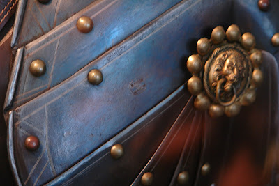

OK, something else I noticed on Vizael's blog: this half-armour, with the same kind of spoked pauldrons:
Detail:
You can see the very same little grotesque face with the ring - almost like a little door knocker - that is present on Monsieur Sillyface's armour, as well as Mr. Gutshot at the Higgins Armoury. Surely this has to be more than just a coincidence?
Was this a Swiss style, or a French style?

PostPosted: Mon 15 Feb, 2010 2:15 pm    Post subject:         Reply with quote
Look like the just the thing for attaching a rope or chain. Where might the other end go?
On the sword? To make sure it's not lost in battle?

PostPosted: Thu 18 Feb, 2010 9:14 am    Post subject:         Reply with quote
Not likely this late in history. The sabers that were used by cuirassiers from horseback during the late-16th century would have been secondary weapons to a number of firearms that they'd have at their disposal, and from horseback if the weapon were attached to a man's body it could be fairly hazardous if it became stuck or pulled away from him, possibly resulting in dismounting.
Personally, I'll bet the rings were there to tie powder and ball loads to. Having a string of them across the chest was common practice later on, such as during the ECW era. Start at the belt and bring the string up across the shoulder, maybe even have another couple on the back for back-up use? I'm sorry I don't know the proper term for what I'm talking about. But I'm sure I've described it well enough that someone who does can probably chime in!
