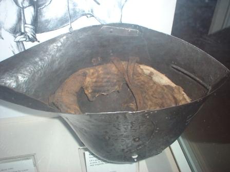

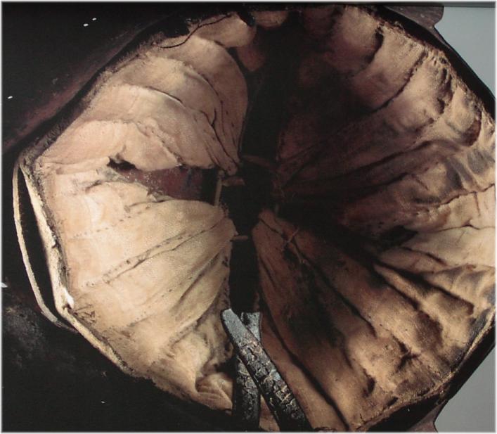

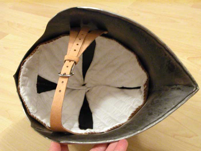

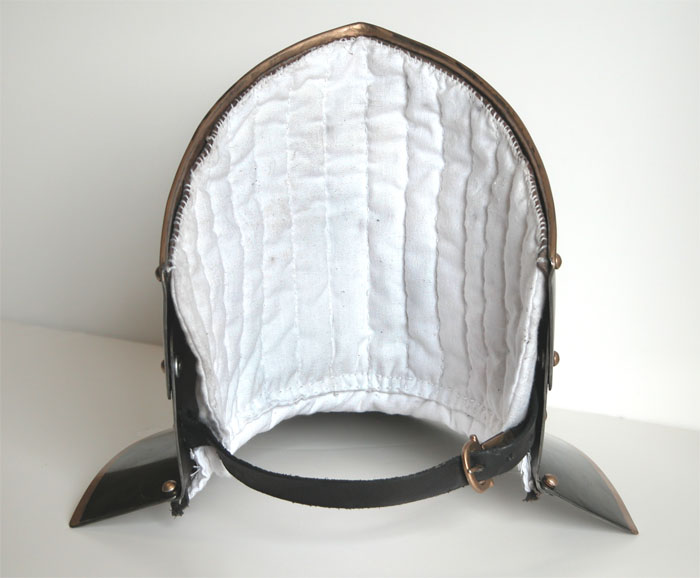

I do not want to sound pushy or mean in any way at all but you really should learn how to put it in and out as the helmet will need repair and cleaning if used. That said if you have the money for it you can simply disregard my comment.
Here is a liner for a sallet in the RA for reference
RPM
 Attachment: 19.93 KB

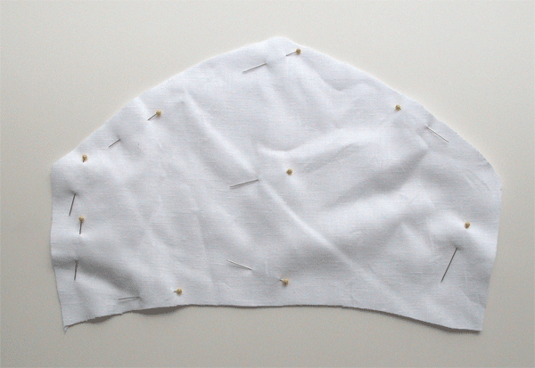

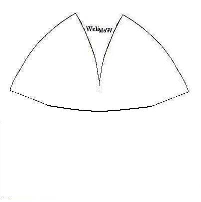

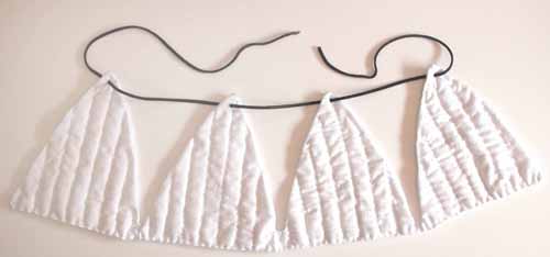

That works but if you want a place to start....
I can tell you how to make it from scratch if you like.
Here is a basic pattern I just made up. You will need to make 4 of them made of a heavy cotton of linen. You will have to adjust them for your own head and helmet. Make sure to add 1/2 to and inch for seams. You will also need either a leather or heavy canvas strip. If using a canvas strip you will need to double the width to avoid the ends fraying, the double ends will be inside the liner itself. You will also need to find rolled cotton. They usually are found in big medical supplies stores.
First you will line up the strip will be lined up with the inside of the liner material along the bottom so all open ends are the same. Once you have done sew up the outer sides of the liner as well. Leave the inside open for the moment.
Now flip it right side up. Cut out the cotton roll to the shape of the liner w/out the strap. You may need to cut a few out depending on the thickness required. Now put them inside. Once everything is set right you can fold the inner (open) edges inside and sew them closed. Now sew some support lines up and down on the liner body to keep the padding in place. Now make some heavy eyelets or grommets at the top of the four corners (a cm and a half or more from the edges) for the draw string. Lastly make sure to place it inside your helmet with the liner facing down and the strip facing up. Rivet or sew it and then flip it inside the helmet skull.
If you have any questions let me know.
RPM

Why do I need to make four of them? How do I know how large to make it? Also, the helmet already has a leather band inside so I guess I wouldn't have to sew a band onto the edge.
Rick
Randall Moffett
Location: Northern Utah
Joined: 07 Jun 2006
Posts: 2,121
PostPosted: Mon 03 May, 2010 7:10 am    Post subject:         Reply with quote
Rick,
Not a problem. The liner must fit directly on your head so the distance around your brow line /should be/is the length of the bottom of the liner. This is normally how I make them for helmets I have made thought. I'd measure the inside of the helmet and see the distance where your brow line would go. If the number is vastly different then it is better to make it fit closer the helmet numbers than your head but will need some modifications. You will likely need a neck strap anyways so that will help either way. If it is loose you could always increase the padding as well. This will keep it on your head and make it better for comfort. Keep in mind the padding needed will increase the size of your head by 2-3" or more depending on how much you wish. So if you have a 23" inch head it will be 25 or 26" helmet.
Why four 'fingers' on it? I do not know. Several medieval examples are four and it seems to work well. A note on something I forgot to put in is that the fingers should not follow all the way to the top of the helmet. You need them to be short enought to tighten and rest on your head to make sure you can see out the visor slit or face opening!
You can use the leather strap already inside I suspect. Might be easier to punch wholes in the leather before sewing!
I hope that helps answer your questions!

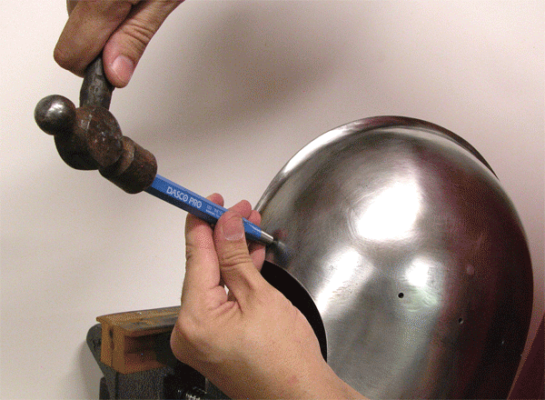

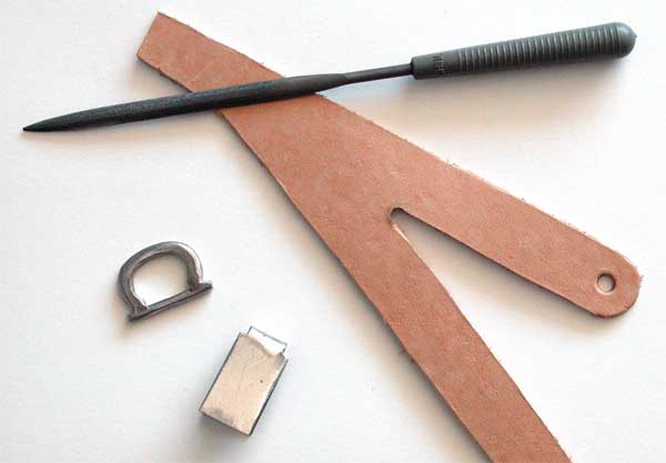

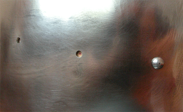

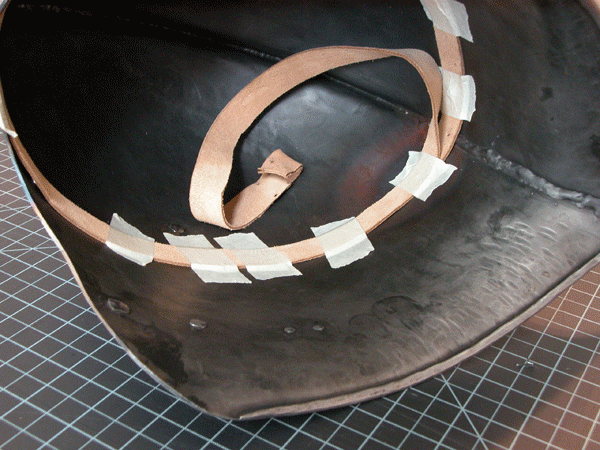

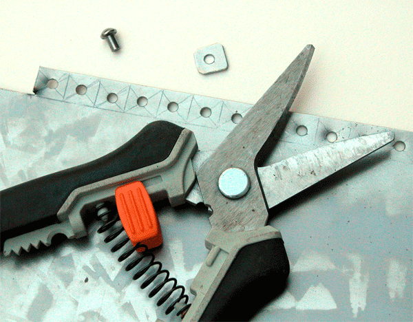

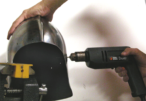

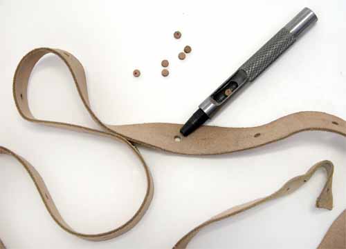

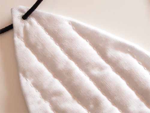

Some shots from my first adventure in sallet lining (in step-by-step order, starting with using a center punch to mark the bowl for drilling). I'd do a few things differently now and everyone has to work according to their materials and aesthetic. Among other things, I'd use more padding. Cotton batting gets significantly compressed during the quilting. I'd use shorter peaks, too, and figure the seam allowances more carefully. A first attempt. Don't hesitate to ask questions. But this is the basic progression from bucket to helmet. Big Grin
 Attachment: 142.93 KB

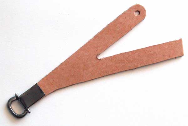

Forgot the washers and straps! Also, here's a shot of the bevor liner under construction--two layers pinned together. I sewed together three edges, turned the piece, inserted the cotton batting and folded in and and stitched the lower edge. Then I pinned through the piece in several places to hold the batting in place for quilting. I made the sallet liner the same way. See, it really isn't hard. Big Grin
On the straps--note that one arm of the "Y" is left unfinished at this early stage. That's so I could temporarily install the straps, buckle under my chin and mark the correct position for the rear arm of the "Y". If you just install the straps without careful fitting they'll probably be uncomfortable and might not work properly.

Thanks for the pictures Sean. They're a tremendous help. I have a few questions if I may.

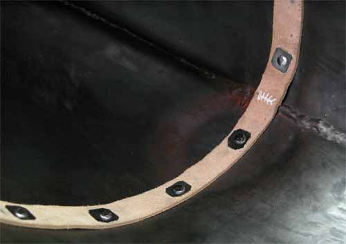

My helmet is being made by Francois L'Archeveque, and has a leather band already installed and pierced for sewing in the liner, so that is one task out of the way.
My first question is how thick should I make the cotton batting? Secondly, when measuring for the points, am I correct in thinking that I should measure from just above my ear to the center of my head and subtract a little so that the points don't quite meet? How do I make the round holes for the thong? And lastly, what material should I use for the thong?
Thanks for your help and patience,
Rick

A sallet by Francois L'Archeveque deserves the best! With the lining band installed and pierced for stitching, all of the hard work is done Big Grin I bought some good natural-colored linen for about $11 for a yard last week. I use "organic cotton batting" from the fabric store, too. That seems to be pretty close to what was used, historically. See this thread for discussion:
http://www.wolfeargent.com/cgi-bin/ultimatebb...p;t=000157
Note that Jeffrey Hedgecock recommends starting with 1" thickness of stuffing/batting to compress to .5" when quilted. Note, also, the discussion of extant liners in the Wallace Collection, with indirect testimony by curator David Edge.
As for measuring--I did what you're describing--measuring from above the ear to top of head. I allowed too much material, though, so my peaks were too long. If that happens to you, just fold over the peaks to the outside and stitch the tips in place to create a channel through which you can run a thong. That's an historically correct option. I used eyelets made by pushing a pencil through the peaks and reinforcing the edges with stitching (see image below). I used a square-section leather thong but some surviving liners appear to have something more like a thin leather lace.
 Attachment: 46.29 KB

The worst that can happen is that you end up having to buy a liner. This way, you'll get some new skills and maybe save some money, too.
By the way, my stitched rows are too neat and close. I used tape as a guide and fell into a pattern of close stitches. Most of what you see on extant liners is "looser". Here's one from Churburg:
 Attachment: 55.35 KB

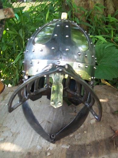

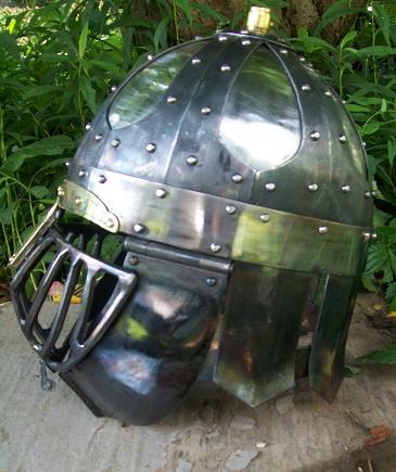

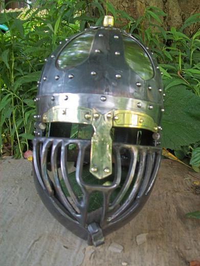

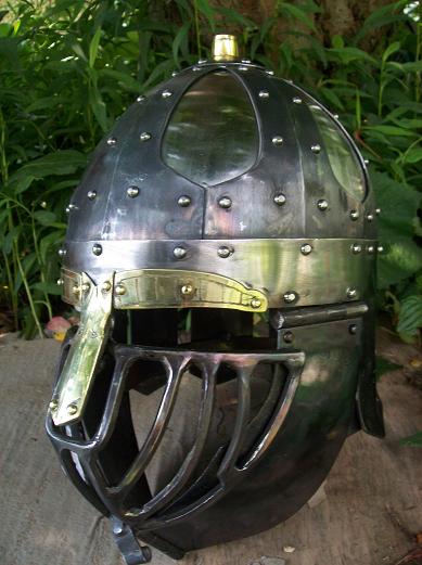

Will that type of liner work for a Spangen Helm and be SCA legal?.. I added so pictures of my helm.
 Attachment: 55.32 KB
 Attachment: 49.39 KB
 Attachment: 54.39 KB
 Attachment: 55.62 KB
 Attachment: 56.09 KB
Randall Moffett
Joined: 07 Jun 2006
Posts: 2,121
PostPosted: Sat 28 Aug, 2010 3:41 pm    Post subject:         Reply with quote
I am not a marshal so you might ask your first but I know loads of people in the SCA with a set up like this. Just need to meet the minimum thickness requirements.
RPM

Just follow Sean's instructions and make sure it's 0.5 inches thick. You may have to re-stuff after the padding compacts over time. Marshals in my region has been checking for this recently.
8. All parts of the helm that might cause injurious contact with the wearer’s head shall be padded with a minimum of ½ inch (12.7mm) of closed-cell foam or equivalent padding, or shall be suspended in such a way as to prevent contact with the wearer during combat. Similarly, parts of the inside of the helm that might come in contact with the wearer’s neck or body should be padded.
9. All helms shall be equipped with a chinstrap or equivalent means to prevent the helm from being dislodged or metal contacting the wearer’s face during combat. An equivalent might be, for example, a bevor or a chin-cup suspension system. A “snug fit” is NOT an equivalent. The chinstrap shall be at a minimum a ½ inch (12.7mm) in width and shall not be placed in the helm in a manner that could strangle the wearer.
http://www.sca.org/officers/marshal/docs/marshal_handbook.pdf
