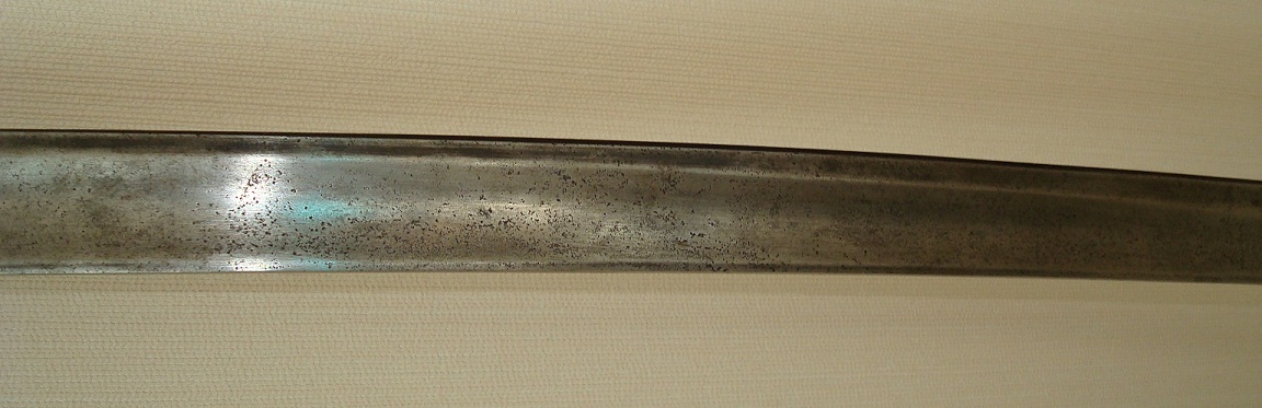

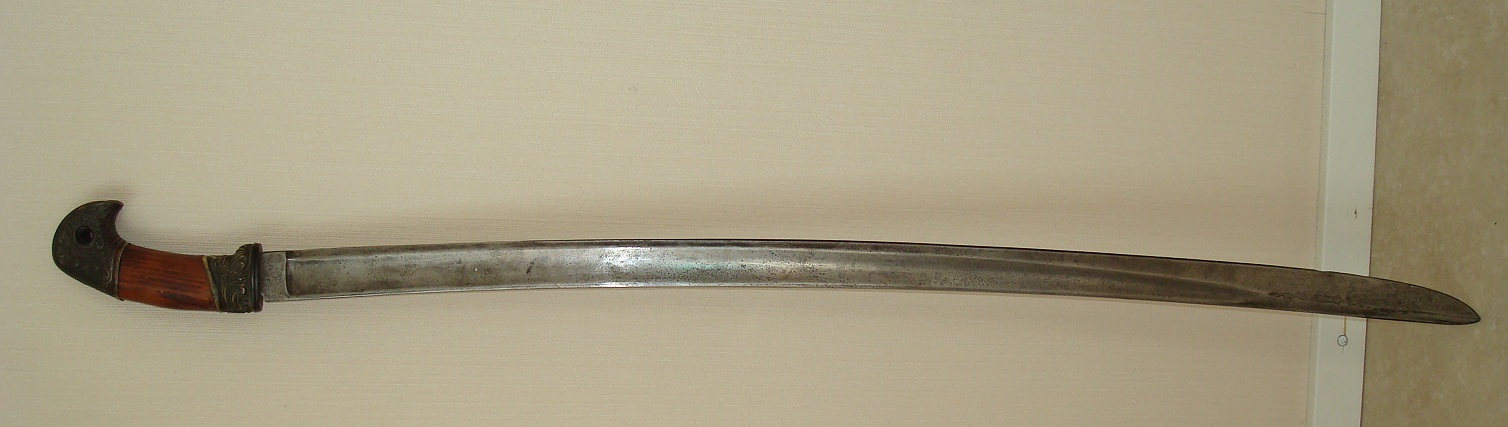

A friend of mine asked if I could identify a sword he has around his house, aparently, something his grandfather have acquired at some point between 1950ies and 1970ies. Since that sort of blades usually falls outside my own period of interest, perharps someone can shed some light?
Attachment: 31.23 KB
Attachment: 71.23 KB
Attachment: 174.41 KB
Attachment: 158.42 KB

I think it's shaska... Russian or Ukrainian. But if it is original or not and what date, I have no idea...
Timo Nieminen
Posted: Thu 18 Mar, 2010 2:34 pm Post subject: |
It's a shashka, a Cossack sabre, adopted by the Russians as a standard cavalry sword, continued in use in the Soviet Union.
This is in the style of the standard military version, but has ornamentation on the pommel that isn't on the standard sword. So, it's either an officer's sword (don't know if they were allowed fancy ones in the Red Army, but before then it would seem likely), a presentation sword, a civilian sword based on the military pattern, or a tourist piece or fake.
There are very many low-quality Chinese fakes to be found on ebay etc.; this is not one of them (and wouldn't be, from the age). A better replica (and sold as such) is by Weapon Edge, available from and viewable at http://www.stromloswords.com/russian_swords.html - compare the ornamentation on this with your friend's.
Kizlyar make some nice modern shashkas, of the more traditional style rather than the derived military pattern; I have their basic model and it's an agile 700g, very nice for light targets. (Google image for "kizlyar shashka" and you will see.)

Thank you for quick response! With this information we can look deeper into the swords of this type and perharps come up with more detailed information about it's past.
