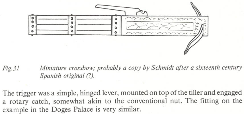

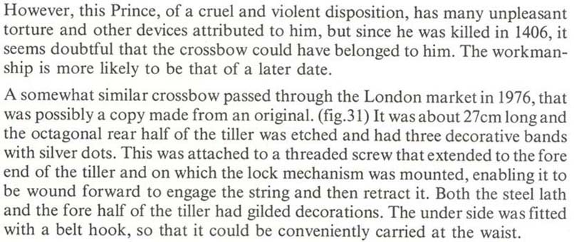

The attached pictures are from the book "A Guide to the Crossbow by W.F. Patterson", pages 105 to 107 that deal with the Balestrino (miniature crossbows).
I hope they are pasted in order.
Pic 1 - Starts with heading Miniature crossbows and text
Pic 2 - Pic of Balestrino from the Doges Palace
Pic 3 - Text, starts with "However, this prince...."
Pic 4 - Fig. 31 illustration and text
Pic 5 - Text, starts with "In the city...."
