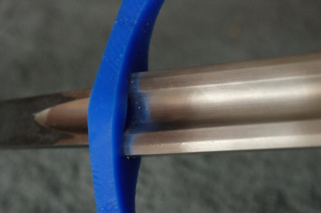

The long-awaited Dane is getting closer to completion.
Here are photos of the rough waxes Peter sent along today.
A few more photos here:

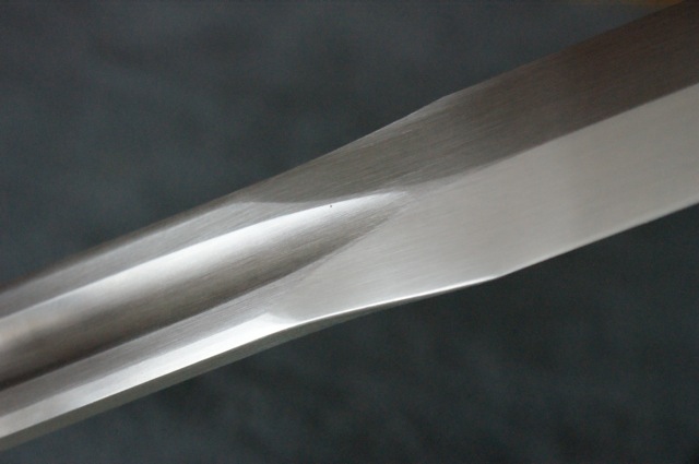

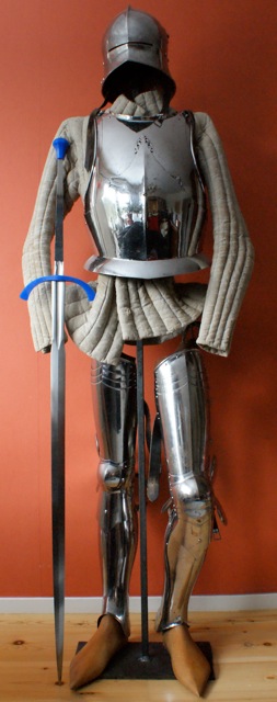

Yes, carving guard and pommel in wax is the normal procedure when I develop swords for Albion. It allows me to shape these so they have the typical shape of forged originals, without actually forging them. Working in wax allows me to add and remove without constrain. It is a material that allows precise shaping and can be worked rather quickly in the rough: you can use rasps, files, handsaws and scrapers but also turning on a lathe or even mill it if you have such a machine.
I work with simple hand tools, just as it lets me get the character of the forged and had filed part looked like on original swords.
Below I attach another image that show the size and proportion of the sword better. It is my half finished old armour. I am 1.84 cm tall and the pommel reach shoulder height when I stand straight. From tip to pommel the Dane is 147.5 cm ( 53"). The blade, including ricasso is about 107 cm (42"). At its widest the blade is 4 cm (1.57"). The point is 0.4 cm thick (0.16").
Even without pommel and grip, this blade is surprisingly agile. With the long grip it is almost halfway to a pole arm. The blade will allow both cut and thrust and the sturdy ricasso can be gripped to shorten the weapon. Is such a grip it reminds me of a pole axe. The point is both sturdy and sharp. It would probably thrust through padding and possibly burst mail rings. It is narrow enough so that it would only have to break one ring and the result would be a deep wound.
EDIT: adding two close up pics showing details of the ricasso and start of the edges.

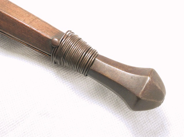

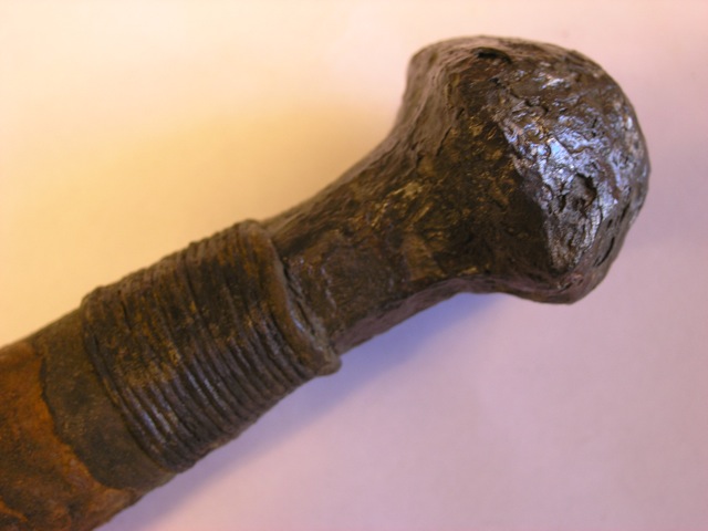

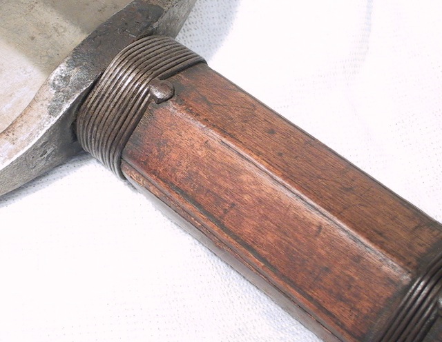

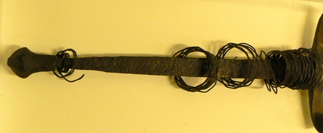

In preparation of the Dane, I have looked at quite a few swords of this family. A feature that just about every one of them share is the wire wrapping that is set at intervals along the grip. It is as a rule done in the same way with domed tack holding down the ends of the wire. Some have leather over the wood but under the wire, other have bare wood below the wire wrap. The Dane will have leather under the wire wrap.
 Attachment: 63.88 KB

PostPosted: Thu 04 Mar, 2010 1:42 am    Post subject:         Reply with quote
Great pictures!
I really like this bare wood with wire look, especially when it looks somehow "aged" like on the last photo.
Does anyone know why some swords like those had bare wood grips?
Or maybe why most medieval swords had leather grips when bare wood could work too?
I understand that this is probably question like " why some roofs are ceramic and other not", but still I'm curious. Wink

PostPosted: Thu 04 Mar, 2010 2:36 am    Post subject:         Reply with quote
Bartek Strojek wrote:
Great pictures!
Does anyone know why some like that had bare wood grips?
Good question. I have no good answer. Happy
I think the wood on the sword was actually stained to begin with. Possibly bark from a common type of tree that grows close to water, and has small cones even if it is a leaf tree. I don´t know the name in English. In Swedish it is "Al". Its bark can dye wood into a red/mahogany hue.
