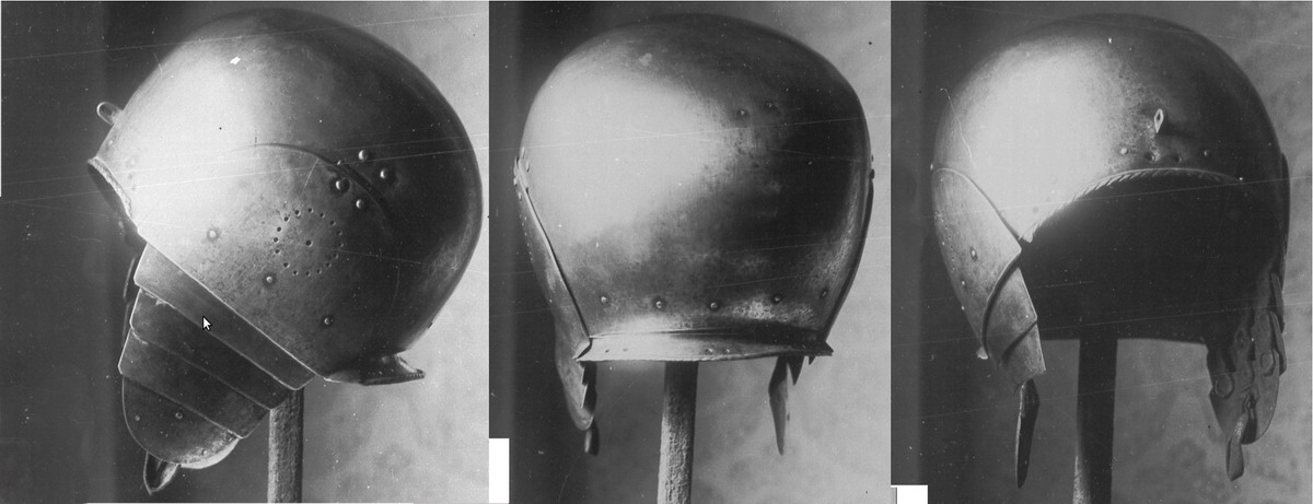

Hello,
I urgently need to have information on the helmet of the photo, Question precise dating, collection or museum where it is and if there are other photos of this model. help!
I also need to know what good was the ring that is located on the front of the helmet.
thanks
 Attachment: 123.79 KB

I my self would like to know more about this helmet. I have posted your pic if you don't mine for user to view on. hopefully this would help them identify more quickly ..

PostPosted: Tue 15 Dec, 2009 9:26 am    Post subject:         Reply with quote
This is an early form of burgeonette, sometimes I believe refered to as a sturmheub. I believe this one dates to around 1500-1510. I would assume that the piece on the front was perhaps for some sort of face plate. I may be wrong but I believe at the time this picture was taken ( c. 1900- 1920 ) it was in the German National Museum. The pic is from before the war so where it is now I don't know.

PostPosted: Tue 15 Dec, 2009 10:20 am    Post subject: Helmet         Reply with quote
Alberto,
This probably won't help much, but just to add to the info from Allan.....
There is a fluted Austrian armet (1510-20) in the Victoria and Albert Museum that has a very similar staple. In this case it is mounted on the overlapping right cheek piece. A photo caption of 1960s states, "The staple pierced with an eye........is a peculiar feature; its function is uncertain." I have always thought it was for some sort of reinforcing plate for the chin joint.
Thanks for posting the photos. Have only seen a few similar helmets, but only in woodcuts, etc.
Regards,
Dan
PostPosted: Tue 15 Dec, 2009 11:58 am    Post subject:         Reply with quote
As Allan said. It was an extremely common light infantry helmet, judging from Austrian art of the period. I've always assumed that the staple is for a narrow pivoting nasal, and I vaguely recall seeing that in a Dürer woodcut. A variant of this helmet is made of small overlapping scales, presumably stitched to a padded fabric cap. Here is a TINY sampling of Austrian images to chew on--there are hundreds at IMAREAL:

PostPosted: Tue 15 Dec, 2009 1:48 pm    Post subject:         Reply with quote
This is typical, ca. 1517. Discussion here: http://www.myArmoury.com/talk/viewtopic.php?t=11664
 Attachment: 72.86 KB
