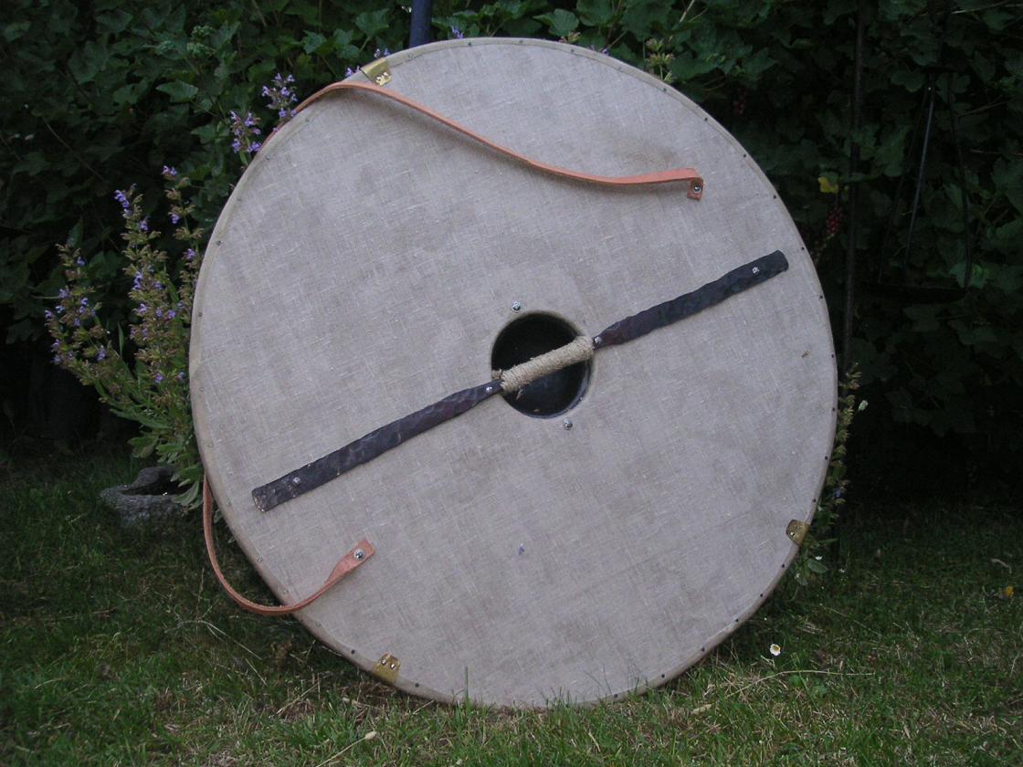

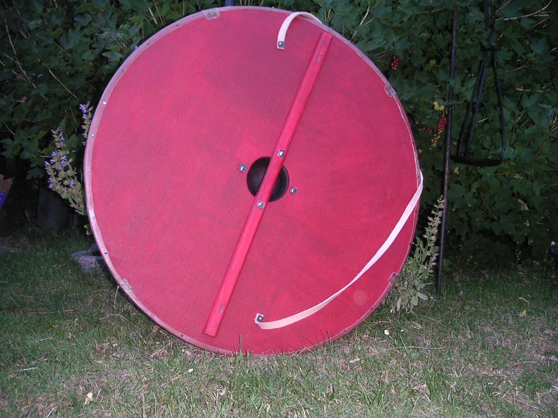

Here are some grips. Some made of wood and some in iron.

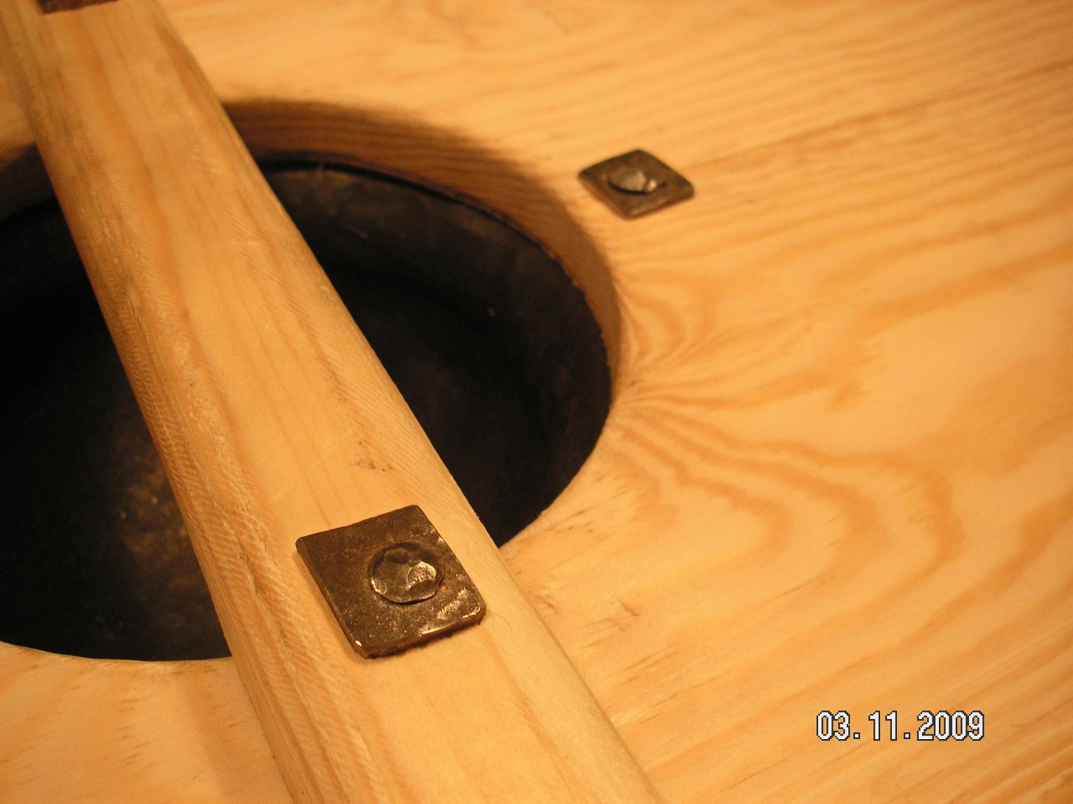

I use iron rivets and or nails.
If you use rivets it looks nicer with handmade rivets and handmade washers.
The same with nails. Make sure you use long nails that can be bent on the backside to secure them.
I photographed the rivet.
