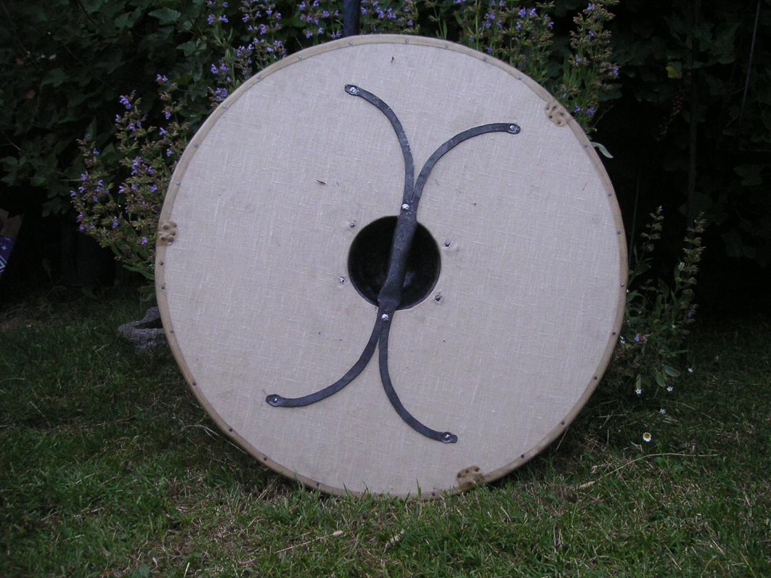

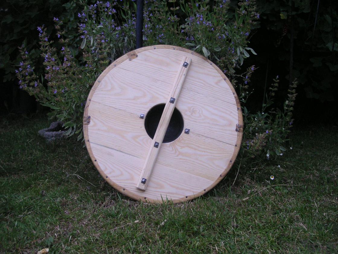

Viktor the two last of the shields are my style but what did you use to stick them in place and im speaking of the grip of course.
We usually just nail them on. You can either use the same nails that you use to attatch the boss, or separate ones. Be sure to offsett the handle so that your hand (incluing any gloves) fits comfortably, though.
I use iron rivets and or nails.
If you use rivets it looks nicer with handmade rivets and handmade washers.
The same with nails. Make sure you use long nails that can be bent on the backside to secure them.
I photographed the rivet.
And I found a good painting on the net wich will show you the basics.
with an old brown color the style of the shield would be magnificent!!! :eek:
The old brown color will come naturally after a while ;)
