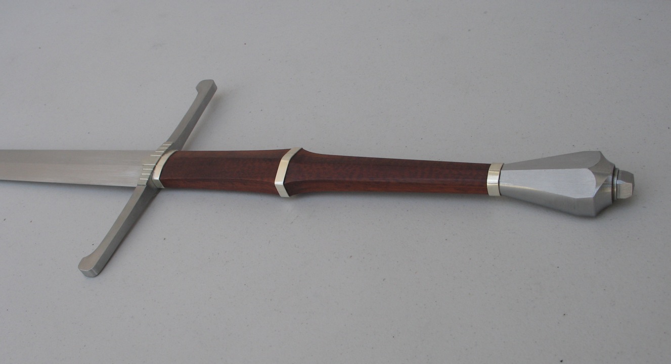

I have been utilizing my free time lately being productive in the art of swordmaking.
I would like to share with you my latest creation with the following specs:
Total length ---------- 55 3/16 inches
Blade length --------- 40 3/8
Handle length ------- 11 1/8
Thickness at base -- 0.245
Width at base -------- 1.665
COG -------------------- 3 7/8 inches from the cross
COP -------------------- 24 1/2 inches from the cross
Blade steel ----------- 5160 spring steel
Weight ----------------- 4 lb 2 oz
Than handle is dismountable and made of snakewood with sterling silver bands. I may embelish the sword at a later date with Lapis Lazulis, onyx or some other precious stones to further the beauty of this sword.
Your comments are welcome and are very appreciated.

Stunning, really your best work thus far. I've been silently impressed up until now, but this is true mastery, you should be very, very proud to own such a piece, let alone to have crafted it.

Looks nice. Did you make the whole piece from scratch? I'm not sure that adding stones would necessarily add to the piece; I think it would distract from the overall form. But then again, I am something of a "less is more" type.
Personally, I would like to see a bit more going on in the guard, like a less linear taper, or maybe rounded ends. That's a matter of personal taste though.

G. Ghazarian

Roger, I don't mean any disrespect to your opinion, I called the sword belonging to the XVIIIb type because that's what it looked like to me, granted she is enormous, but still looked like XVIIIb. Then again, as Chad wisely put it :

Thanks for asking Addison. I make everything from scratch and I make them myself. The only thing I had made by others is the heat treating, which was done by a reputable professional firm used by most professional swordmakers. It's not worth taking chances for something as important as that.
As for embellishment with precious stones, I agree, beauty in simplicity is the best policy. Maybe some other time for some other sword. No wonder I was debating with this idea.

Beautiful sword. I have always been a sucker for exotic hardwood, so I am always pleased to see it. I know leather wrap is perhaps more traditional, but I love the wood. The lines and proportions of this sword are very nice too. Well done.
This comment holds a valid merit. So I decided to make some modifications on the cross and here is what I came up with (see picture). Thanks again Addison.
While I was making modifications, I also ground the blade and gave a more pointy profile taper and a satin finish all over.
These modifications shaved off a good 2 ounces from the sword and brought the COG to 3 5/8 inches.
