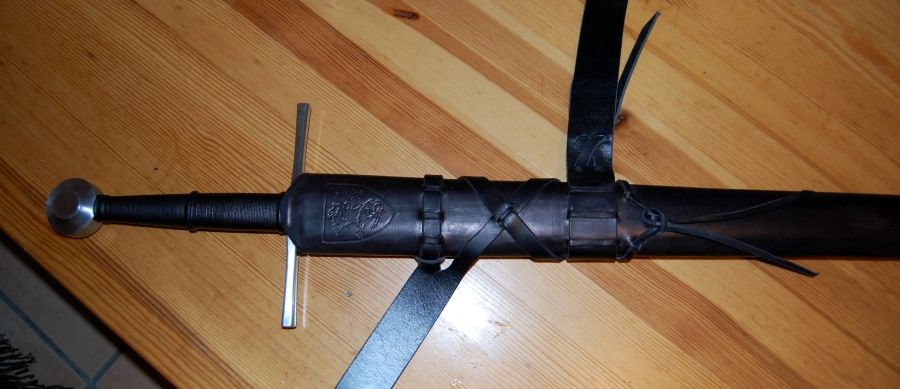

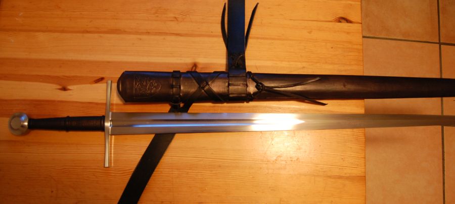

I am in the process of making a scabbard for my first and only sword. I've never tried my hand at such a thing before, so several threads here at myArmoury have provided tremendous help in the process, basically guiding me along the way. I don't know how useful his post will be at helping others trying the same thing, but I'm posting it anyway in case anyone should find it interesting.
The scabbard is completely ahistorical, it has a fiberglass laminated balsa wood core.
Right now I am trying to make a chape from a steel sheet, and I also lack a belt buckle. Furthermore, some decorative lines on the scabbard and suspension remains undone for now.
 Attachment: 119.95 KB
 Attachment: 107.66 KB

That is a good scabbard.
Balsa wood with fiber glass is a creative solution. It should work well.
Considering this is your first scabbard you should feel proud of your efforts: it does not look like a first attempt :-)

Ole, this looks pretty good from the photos you've posted. I'd love to hear more about how you built the core.
Keep at it Happy
Al.

Good work. I think we may have another scabbard-master in the making.
Mind if we see the other side?

Qualifying your work as a mere attempt seems an understatement though, as your finished core and suspensions are way more convincing than that Happy
A close up of the coat of arms would be nice (carved? imprint?). Balsa coated with fiberglass is an interesting shortcut, one that I might try on future projects, depending on how easy fiberglass is to handle.
Anyway congrats and keep up the good work.

Seeing as I just finished up my first scabbard attempt, I think you nailed it! The scabbard seems well proportioned, the leather work looks nice and consistent, and I like the decorative element near the throat. Very well done!

I would appreciate pictures of the mouth and back. (These tend to be the tricky parts!)

Al Muckart- Regarding the core: Two halves were shaped from balsa wood in the usual way. I proceeded to glue the two halves together using epoxy glue. When the epoxy had dried, I laminated the scabbard in fiberglass, one side at a time. I looked at model aircraft websites for instructions, as they laminate model airplane wings this way. As a result, the inside of the scabbard is non-corrosive to the steel due to balsa wood contacting the blade, while the outer layer of fiberglass makes the scabbard stronger than conventional wooden scabbards. The core is tight enough to hold the scabbard upside down without the sword falling out. A light tug is required in order to unsheath the sword.
M. Eversberg II - Thanks for your comment! I will proceed to post pictures of the seam when I am done with the chape and decorative lines.
Julien M - I was hoping you would comment on this thread, as your excellent homemade scabbard was the deciding factor as I decided to try to make a scabbard of my own for this sword. I'll take a close-up of the coat of arms as soon as I have finished the chape etc. It decipts a griffin, and was impressed into the leather using an empty ballpoint pen prior to the initial colouring. Regarding fiberglass - it is not hard at all - in fact it was the easiest step in the scabbard making process, in stark contrast to the leatherwork which I found surprisingly difficult.
Michael Pikula - Your comments are appreciated! I am always interested to see DIY scabbards - are you planning to post some pictures?
Jared Smith - It's interesting that you should mention this - it's one of the methods which I initially considered trying for the scabbard core, along with the veneer laminate earlier mentioned in other threads by mr. Peter Johnsson.

Ole, I don't known what impresses me most. Your beautiful scabbard or the idea to use an empty ballpoint pen for the griffin. Using that pen is really a creative idea. Let me say that it is no wonder you made such a beautiful scabbard if you came upon that idea.
One question: what is the thickness of the leather you used for the scabbard and is the belt made from leather of the same thickness.
