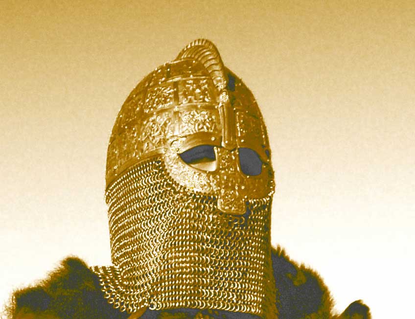

I would like to share with you first version of Vendel 1 helmet, made by me.
Hole helmet was made solely by me, including decoration. I have only commissioned the moulding in a professional foundry.
I am attaching two photos of my reproduction and one photo of original find. More (and bigger) photos you will find here
http://www.thorkil.ovh.org/vendel1_eng.htm
And now about the helmet.
The bowl :
- two halves heat tread and hand forged of 2mm middle carbon, constructional steel,
- two halves welded together,
- finishing - not polished, only cleaned to achieve more authentic look and to show facture of the steel after "hot forging".
Decoration:
- crest, eyebrows and plates (plaques) casted of brass,
- the look of the decoration is exactly like on original helmet, with every detail.
Helmet has hooks for aventail, like original has.
My opinion about the helmet:
I am very proud of this replica, as it is first Vendel helmet that I have made with such details. I have spent a lot of time for researching (and for work, while making this item.
However... The helmet is not ideal.
- two halves were welded with using nowadays techniques (electric tools). But I plan to reconstruct also this aspect in my future productions,
- in original helmet decorated plates have been made with using press-blech technique . In mine replica they are casted. Why? Making first version of this helmet was big experiment for me. First, I made molds of the plates, as I wasn't sure if I will be able to use historical press-blech technique. But, I made few experiments with press-blech technique and now I am sure that this will work and looks very good, because I made first plate in this technique, so I am going to make this way next helmets,
- the crest in original helmet was made of several bronze plates and casted "animal heads" at the front and back of the helmet. I have casted the crest together with "animal heads", as making it with historical technique will extend the cost of helmet a lot. I hope I will have opportunity to reconstruct technique used in original helmet, one day,
- original helmet had decoration also on spectacle. In this version there isn't any decoration in that place, but next helmets will have it;
- this version has only one row plates around the bowl, but next helmets will have more plates, like original find has;
- decoration is made of brass, not in bronze,
- in my opinion nasal is a bit too narrow and the bowl is a bit too .... how to write it in English... sides of helmet should be more vertical, as they are too round, IMO.
So, next helmets will be better, because making first version was one, big experiment and I already have wide experience, now :
1) they will have decorated plated made in historical technique (press-blech),
2) they will have more than one row of decorated plates,
3) they will have decoration on spectacle, as well,
4) the nasal and bowl will have better shape.
Enjoy the photos and feel free to comment.
Best regards from Poland, Thorkil.
P.S. Sorry for my English. I hope everything is understandable.
