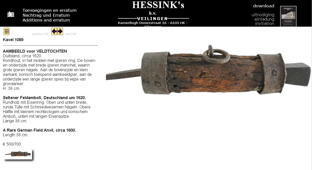

Hi John........I work with making this sort of gear pretty much full time now.....and what I'd be doing is sniffing around to try and find steel pipe of a resonable diameter....you'll only need a few inches of it. Sometimes the metal supply companies or metal manufactures will cut you off some from workshop leftovers. If you can get some treated pine outdoor log slightly bigger than the pipe then your almost there. Actually, if you make the same thing a bit longer, put a metal band on both ends with a ground spike in one end and a small steak in the other, then you got yourself an authentic type of field anvil !
Cheers !
Attachment: 53.68 KB
Merv ....... KOLR
Gavin Kisebach
Posted: Tue 21 Aug, 2007 7:58 pm Post subject: |
Merv that's a great picture, where did you come across that? I've never heard of such a thing. Very cool.

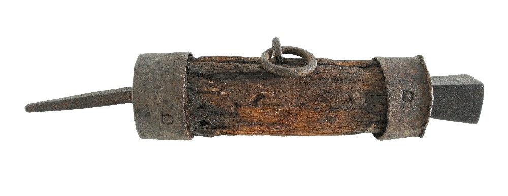

Posted: Wed 22 Aug, 2007 7:41 am Post subject: Field Anvil |
Gavin Kisebach wrote: | Merv that's a great picture, where did you come across that? I've never heard of such a thing. Very cool. |
Hi Gavin.......Yes, I am constantly suprised whats lurking around in museums, books, auctions and private collections. I am always finding ( on-line mostly ) things that I never knew existed.......or, sometimes one assumes that some particular thing must have existed like the field-anvil, but to actually see one is suprising.
I dont mean to skip the subject of this post, but, in fact, the anvil is made the same way as a maul so it is interresting. Perhaps there is an original maul out there too somewhere ?
Attachment: 93.74 KB
Merv ....... KOLR
