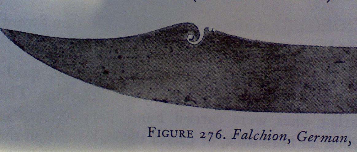

Posted: Wed 18 Jun, 2008 10:06 pm Post subject: |
Here is a falchion from the Metropolitan Museum with some very nice features:
I really like the curl and the small adjacent serration...
Attachment: 94.47 KB

Posted: Thu 19 Jun, 2008 4:57 am Post subject: |
Chris Artman wrote: | Here is a falchion from the Metropolitan Museum with some very nice features:
I really like the curl and the small adjacent serration... |
What's the dating of that falchion? I believe it's likely later than the Thorpe, which means that extra blade stuff may be more appropriate for a later period than for the Thorpe's.
Chris Artman
Posted: Thu 19 Jun, 2008 8:30 am Post subject: |
13th century
Okay, okay, its 15th century, but it is so nice...
Danny Grigg
Posted: Thu 19 Jun, 2008 4:31 pm Post subject: |
Chad
The pic of that falchion is from Stone's "A Glossary of the construction...."
The full description:
"Figure 276. Falchion, German, 15th century. Metropolitan Museum."
Does anyone know if this Falchion is still on display at the Met?
If so anyone got some good pics of it and maybe some more information about it?
Chris any chance you can post some more pics of the Thorpe Falchion showing the entire sword as I've yet to see a good quality colour photo of it.
Thanks
Danny
![](images/avatars/68740306744c916c4ee04c.jpg)
![myArmoury Team myArmoury Team](images/myArmoury-logo.gif)
Posted: Thu 19 Jun, 2008 5:54 pm Post subject: |
Danny Grigg wrote: | Chad
Good to know. Thanks! I just quickly went through my nearly 500 photos from the Met last year and didn't see it. I tried to get one of everything, though some didn't turn out. I don't remember seeing it when I was there, but that doesn't mean it wasn't there.

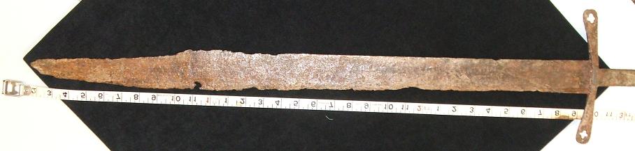

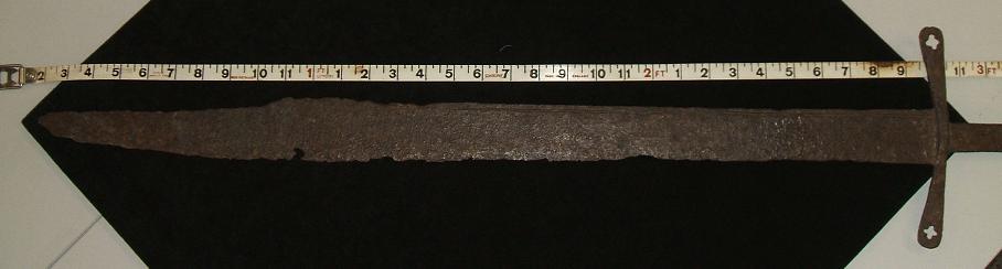

Dan Dickinson
![](images/avatars/22233363947596044c5b48.jpg)
Posted: Thu 19 Jun, 2008 6:40 pm Post subject: |
Thanks
Danny |
Danny, I'm afraid I'm not Chris, but here are a couple of pics that Alan took for me and I have forwarded on to Chris.
They show both sides, illustrating the long fuller on one side and the short ricasso fuller on the other, both with inward turning fuller terminations.
Hope these help,
Dan
Attachment: 41.48 KB
Side with short ricasso fuller [ Download ]
Attachment: 34.12 KB
Side with long fuller [ Download ]
