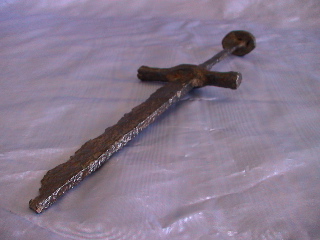

Another image ...
 Attachment: 38.54 KB

Scott Gardner wrote:
I have just recently started following this discussion regarding the seax. I hope that the following is found to be useful, although it may turn out to be a red herring. I have the fragment of a single edged weapon, represented at one time as a 9th or 10th centuary dagger or child's sword, however I am looking in to the possibility that it is a seax. It has a small "tea-cosy" pommel (about 1.25 inches wide, 1 inch deep and .75 inches tall), a 3.5 inch long grip area/tang and a 3 inch wide lower guard. The hilt area is about 4.75 inches in total length. What remains of the blade is about 7/8 inch wide and 6 inches long, although I can see it was longer originally since the end is clearly broken and the ridge on the non-edged side of the blade extends all the way to the tip.
I am looking into the possibility that it could be a seax because of the single edged blade, the width of the blade, and the fact that the grip area is long enough to accomodate a man's hand. On the other hand, it does have a guard, tang and pommel that do not match my previous conception of a seax.
In answer to Jay's most recent question -- assuming the the blade on this piece wasn't much longer than six inches, the distal taper appears to be about that typically seen with a single edged sword ... but take that with a grain of salt since I have no idea of whether this is a seax in the first place!
If it isn't viewed as hi-jacking Jay's topic, I would welcome any and all comments as to what this piece was and how old it could be.
To me this looks like a single edged back-up weapon from the 15th C. A single edged short thrusting sword of some kind. It makes me think of illustrations in Swiss chronicles of the late 15th C. It has some likeness in character to the more bayonette-like Grosse Messers. It is only the fact that the tang is hidden like that of a sword that does not make it a good example of that weapon type. These were very popular and no doubt effective weapons. There is a similar weapon, single edged and with Messer style hilt in the Royal Armouries in Stockholm. This one is classified as a 18th C hunting sword, but it is actually a 15th C Grosse messer.
The weapon in the picture could well have had a blade that was two to three times as long as present length and I would guess the point was triangular in section and very pointy, centered in the blade or in line with the back. A little distal taper, but not overly much (35-45%?). They tend to retain much of the thickness at the point.
A seax also does not have a cross guard like this. Most Seaxes does not have guards at all, just sometimes a reinforcing band around the end of the grip towards the blade. They do sometimes have a pommel-like feature, but this is not always the case and it is normally not used as a counterbalance to the blade, but rather as a rivet block and grip reinforcing. I have only seen one seax with a solid iron "pommel" and this still had the outward form of a tubular reinforcement of the grip. I have lost count of how many seaxes I´ve seen "in the flesh" and only a minority of these ever had any remains of metal mounts in the grip. (if there were any they might have been eaten away or lost of course, but this will still tell us that they were rather reinforcing bands and less of a function as pommel or guard)
A long sax (langseax) is a long bladed weapon that usually has a knife style grip (as a norm with hidden tang and not riveted on slabs) The Long seax can have a long grip, perhaps 25 cm or sometimes even longer. These weapons will have a blade of some 55 cm up to proper sword-length blades. They still do not have sword style hilts however: they are typically mounted just like very big knives: a hidden tang of almost the same width as athe blade secured with pitch and sometimes a rivet at the protruding end.
There are naturally variations to this, but these should not be regarded as typical examples ot the classic seax.
Distal taper of seaxes: All edged weapons will typically have some degree of distal taper. It is a natural result of drawing out the blade blank and is a logical solution when you strive to make an effective and well balanced blade. Distal taper can never be regarded as a isolated feature, but should always be seen in context with the type and function of the blade.
Shorter blades can do with less distal taper and must sometimes retain more mass in the point section to be able to deliver an effecive blow.
The clip point style seaxes manages an effective distribution of mass through the dramatic taper in witdth in the point section and a beefy and sturdy tang. (This is in fact very similar to the principle of tang design on japanese blades) In these weapons you will want some more thickness in the point for it to be an effective cleaving weapon and leather awl. The point is generally of stout triangular section, almost equal sided. Section of the body of the blade is also typically triangular with slightly convex sides. A typical seax is less a big bowie knife and more a nightmarish version of a tanto or wakisashi.
The contintental type with a point of symmetrical silhouette retains more width towards the end and must therefore have a bit more distal taper (as a rule of thumb). This will of course depend on the overall size, lenght and mass of the weapon.
Narrow blades (one inch wide or so) can be surprisinlgy thick in the spine: some 10 - 12 mm. Broader blades will be thinner but will typically be thicker in the spine than would a sword of similar width, perhaps some 6.5 - 8 mm thick at the base for a blade that is 4.5 to 5 cm wide and 40 -55 cm long.
Hope this helps!

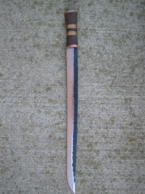

I too was enjoying all of this great information. Thanks to everyone. I love these big knives. From collaberation with Scott Byler, my idea of a war knife
 Attachment: 64.29 KB
