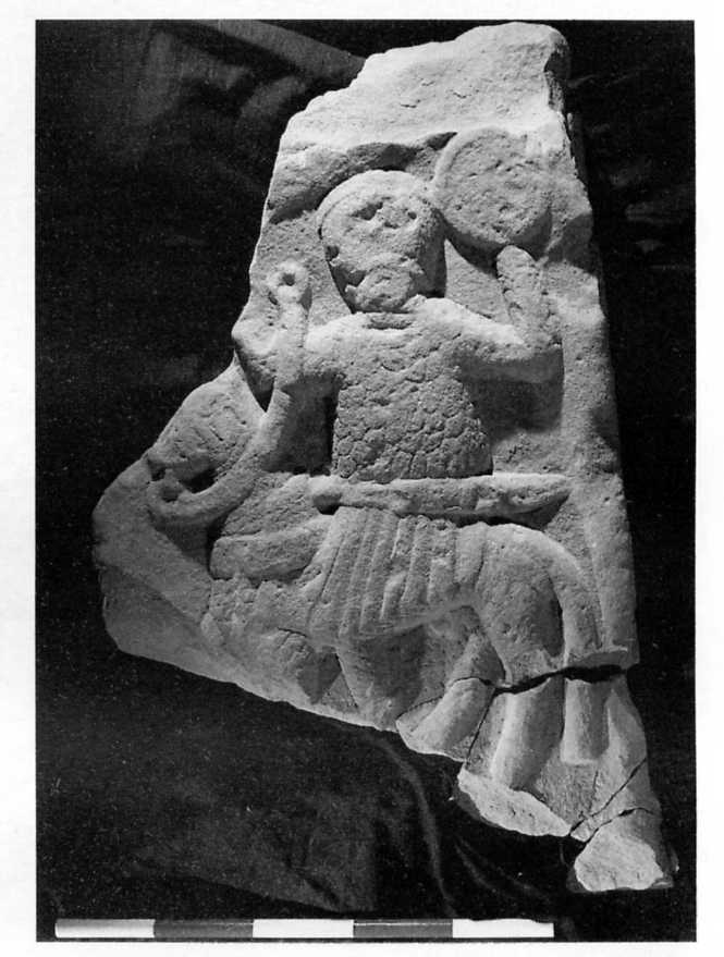

Nate B. give me a copy of Early Anglo-Saxon Shields a couple weeks ago, and I just happened to notice that there is a photo of the Repton stone in it. Seems that the sketch of the Repton stone that is used very often(the one posted earlier) is somewhat off. In the sketch the handle looks somewhat like it might swell at the end. However, this isn't the case when you look at the photo of the stone, it looks more like a sphere on the end of it. Frankly I really don't know what to think about it... It doesn't make it any easier since there is portions of the stone missing in the grip area. Without a better picture or seeing this thing in person I would be hard pressed to say what is going on.
Shane

Shane Allee wrote: | Nate B. give me a copy of Early Anglo-Saxon Shields a couple weeks ago, and I just happened to notice that there is a photo of the Repton stone in it. Seems that the sketch of the Repton stone that is used very often(the one posted earlier) is somewhat off. In the sketch the handle looks somewhat like it might swell at the end. However, this isn't the case when you look at the photo of the stone, it looks more like a sphere on the end of it. Frankly I really don't know what to think about it... It doesn't make it any easier since there is portions of the stone missing in the grip area. Without a better picture or seeing this thing in person I would be hard pressed to say what is going on.
Shane |
It seems then that seax is one of those having some ort of cap or pommellike feature at the end of the grip. What is the dating of this stone? During some periods this seems to have ben a more common feature.

The Repton Stone dates to the 8th century. I know you mentioned buying Early Anglo-Saxon Shields, but I'll still try and scan a copy of the photo and include it with your other stuff.
Shane

We just bought a new three in one, so here is a scan of the photo.
Shane
