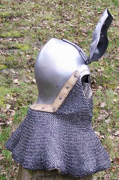

PostPosted: Sun 24 Mar, 2013 1:22 pm    Post subject:         Reply with quote
Well, I don´t argue against sewing the padded liner to the aventail at all. I was just pointing out that there must be a reason to have the aventail attached to the basinet by a string. So there must be a reason for quick detachability. Otherwise you could just sew it to the helmet as well.
There are actually a lot of different face openings in basinets and most reconstruction aventails are not properly shaped to those openings. There was an interesting discussion over at the Armorarchive a while back. There are also ways to make the aventail "bag shaped" around the chin, I am not going so far to say this would be appropriate for what we are looking at, but it was in earlier times. Then, you could also shape the liner more "chin fitted" without changing the hanging maille piece in that area. I don´t say you would need a snug fit there.
I cam eup with that idea when I was modifying my bascinet. It does have a totally different shape than yours, or the most versions. But it has a liner with triangular flaps that attach to the inside of the elongated cheek pieces. Pulling in the liner after putting on the helmet by a drawstring would make it work like a chinstrap.
Another thing that made me think of something chinstrap-like is the fact that most if not all helmets of modern times have something like that, for instance helmet for motor bikes. Those are very snug fitting and still there is a chinstrap, because when there ist uncontrolled force applied, you wouldn´t just rely on a snug fit.
Just some thoughts, to get a clue about the idea in the first sentences.
