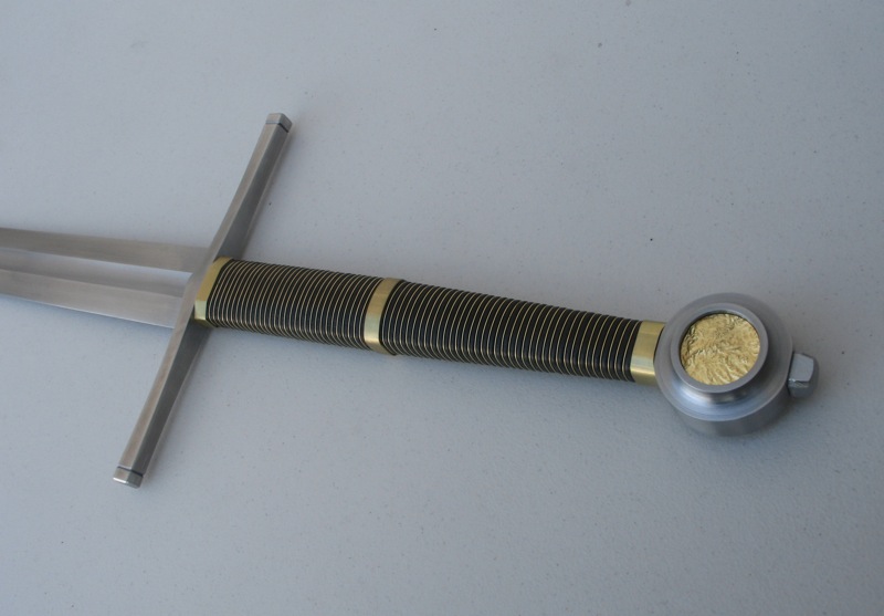

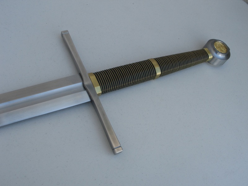

Another one of my latest creations: A classic type XIIIa Sword - This is a cutting machine. Before putting the finishing touches on the sword, I could not resist the temptation of testing her at cutting my ficus hedges with mostly 1 inch diameter branches. She was going in and out of the target effortlessly.
Specs are as follows:
Weight - 5 lb 3 oz
Total Length - 53 1/8 inches
Blade Length - 40 inches
Grip Length - 10 1/4 inches
Point of Balance - 5 inches from the guard
Center of Percussion - 26 inches from the guard
Blade Width - 2 inches
Blade Thickness - 0.260 inches
Steel - 5160 spring steel
I made the blade by stock removal and ground to a satin finish. The handle is dismountable, the cross guard and pommel are of mild steel and a 23K gold leafed reticulated brass insert decorates the pommel. The handle is leaather over chord, over wood and finished with brass bands and wire.
Your comments are welcome and are a source of inspiration for me.
Thanks

This sword looks nice,
5 lbs.- that's really quite hefty= I think this might be a bit much for me personally. It really doesn't look that heavy though by the photos.

I think it looks great. I love the type XIII swords, they do cut!

Thanks guys for your comments.
Jeremy, I'm glad you brought up the matter of weight, which is a compromise in a complex number of several parameters.
Obviously, we shall admit that this is an enormous sword with a blade tapering down to 0.140 inches 5 inches from the tip. By grinding the blade some more and subsequently reducing the weight of the pommel, a few ounces can be taken off and still keep the blade reasonably rigid, a quality that I like in swords. Too much grinding for the sake of making the sword lighter, will result in a whippy blade.
I must admit that the reason I make swords as a hobby, is to have something different than what is available on the market. I already have a large collection of swords that are worth having. I am making what I can not readily buy.
Thanks.

Weight issues aside, that is some glorious design on the furniture.

Hmmm... given the lenght ( 134 cm if I calculated correctly ), the weight is actually not that bad IMO... I'd like to know how this beast handles.
Great work regarding both blade and fittings. Do you have a picture with something to compare the sword to, so I can get a better "feel" of the size?

That looks "perfect" to me. Considering the long blade length (this is really a "Great Sword" or two hander in terms of blade length and grip proportions in my opinion), the weight is high but still within the statistical weight range ( 3 to 6 lbs, many with shorter blades) of historical counterparts. Keeping the blade "stiff" while making it similar in weight to some other blade that is only 75% as long was probably not feasible. I am not sure of any specific reference, but seem to recall descriptions of historical two handers as being somewhat "whippy". I bet the long grip facilitates facilitates surprisingly good handling.

A beautiful sword with a beautiful hilt! I especially love the pommel insert. This sword probably handles better with two hands though.

That is a gorgeous hilt.
