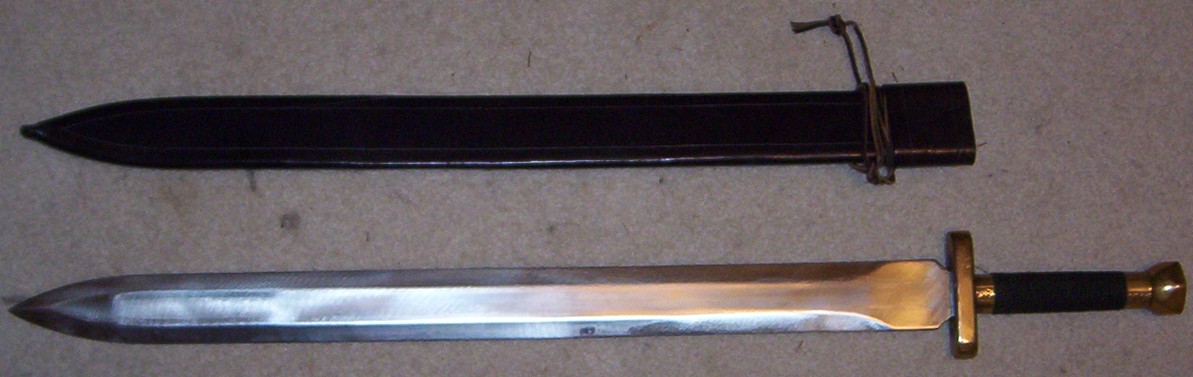

I purchased this sword over 10 years ago from a now defunct shop in Kansas called Skycastle Swords. They, along with their quasi partner Gypsy Madblade made some of the toughest swords I have ever had the pleasure to abuse! I originally purchased the sword sight unseen as a Viking style sword. As can be seen from the “before” pictures, it was anything but a Viking sword. Byzantine? Arabic? Andalusian? Blade geometry was all wrong, not to mention the guard, handle and pommel. But I could not send it back until after the weekend I received it, so I decided to give it a chance. Needless to say, at the end of the weekend I had no intention of sending my treasure back. The only problem as far as I was concerned was the weight. The sword was a beast, with all the swing finesse of a tree branch. It didn’t matter, I still loved it, but that began a 10+ year search for some one willing to add fullers to the Beast, and at the same time reduce some of the weight and terrible handling characteristics (the first picture is the sword before it was sent to Ollin)

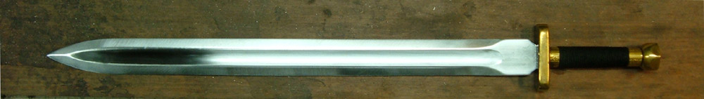

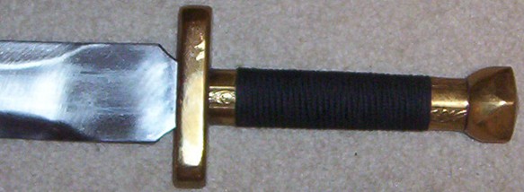

I’m still not sure how the hilt is assembled. The steel, as far as I knew, was from a re-worked leaf spring. The blade cross section was hexagonal, with a large ricasso area. I think the over large ricasso helped in the long run with the project’s success, allowing for more work room on the blade. There was no distal taper to the blade. I opted out of adding a distal taper, as this would have added significantly to the final cost of the project. I won’t go into all of the technical work that Ollin put into the sword: instead here is the thread which best describes the process by which the fullers were added. Below is a picture of the sword with the fullers sketched in. The fullers were hand ground into the existing blade without any warp, discoloration or damage to the blade.
The one thing this picture cannot show is the flaws, which were always part of the blade – minor surface pitting, and irregular coloration from a so-so buffing job. Here is how Ollin Sword Design describes the process: “The fuller was put in by grinding against the appropriate diameter contact wheel on a grinder. That's about as clear as mud, isn't it.... There is a couple of pictures and a little write up of the process on this thread about one our project in the works. The final polish was done with hand sanding, which involves holding sandpaper on a block of wood that has been shaped to match the radius of the fuller.” Here is the link: http://www.myArmoury.com/talk/viewtopic.php?t...;start=100
Once the fullers were finished, the entire blade was beveled and then hand sanded. The resulting blade is now a flawless satin finish. No pitting or other imperfections appear on the blade. Unfortunately, the sanding and added fullers only reduced the weight by 3.5 ounces. This at least brought the beast down to a more manageable 3.5 pounds. The PoB was brought back an inch closer to the hilt, so the sword is a bit handier when swung. That being said, it will never be the agile single hand sword I hoped for, but remains the brute it always was – just a bit easier to wield.

Close-up of hilt before work.

Picture of sword before start of project. [ Download ]

Picture of completed fullers and hand sanding. [ Download ]

Not sure how your Skycastle sword was constructed, as it has a brass hilt, but all of the Skycastle's I have handled were constructed by welding the cross and pommel to the tang, and then filling in the grip between, usually by sandwiching the pommel between a couple pieces of balsa and wrapping with cord.

Posted: Wed 05 Sep, 2007 1:43 pm Post subject: fullering |
