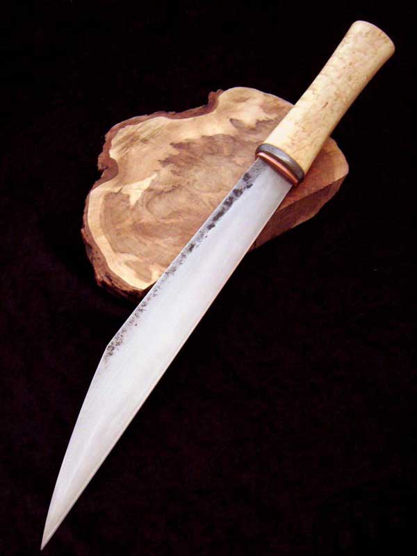

Hi!
I'm a black/bladesmith from Québec (that's in Canada!). I've been working with metal for a few years and got more involved in blademaking in the last 4-5 years. After dabbling in asian blades I came back to european blades lately, throught friends in viking and later medieval reenacment groups.
I guess my knives took up asians element along!
Please look and tell me your impresions!

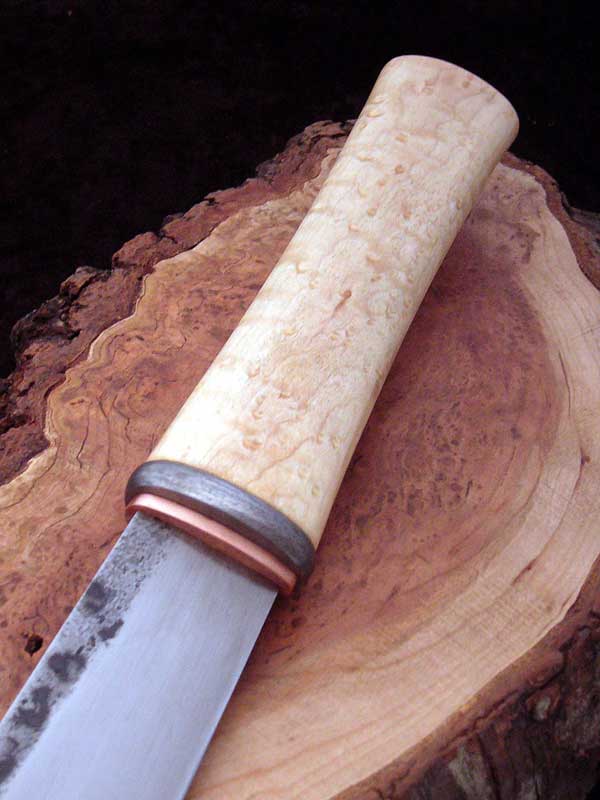

This is the latest scramasax I made.
It is of composite construction (W1 core 1018 sides) The polish is a working polish (and a bit dirty, the owner had it for a couple of days before the picture was taken...) , the core shows only in the sunlihgt. The handle part is copper, wrougth iron and birds eye maple.
It's a heavy and strong blade 1/4 inch tickness for a bit less than the first 1/3 ofthe blade; usually my blades taper much sooner bu the client (and friend now) asked for it...It hit terribly hard!!
Thank's!
Happy to be here there is much to learn on the forum!!

That is very nice.
I really like how the different elements mesh together.

Really nice one!!!
Like it alot!

Back to English: Very nice work and I' m looking forward to seeing more of your work.

Welcome! Very nice seax!!! How about some stats?

I really like that you didn't completely polish the blade. The rougher finish on the spine gives it a very nice highlight. As a blacksmith myself, I like to see a little unobtrusive evidence of that construction.

wow, im really loving that seax, its beautiful.

Tim, the blade is 12 inches and the overall lenght 18 inches.
I'm trying to make a set up for sword lengh blades. Right now 14 inches is a lenght I'm sure of getting good results.

Very nice seax. I love the overall proportions and choice of materials. I think that I would prefer to have the blade completely polished, though.

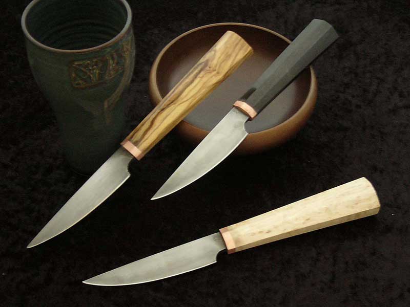

For the medieval event I made little eating knives. In Québec, we almost only see weapons offered at those events (the little I went), everyday knives are rare...probably will make viking one piece knives too.
Here they are.
Composite W1-wrougth iron 4 inches blades. Handles of copper and olive wood, birds eye maple and ebony. Total lenght, about 9 inches.
