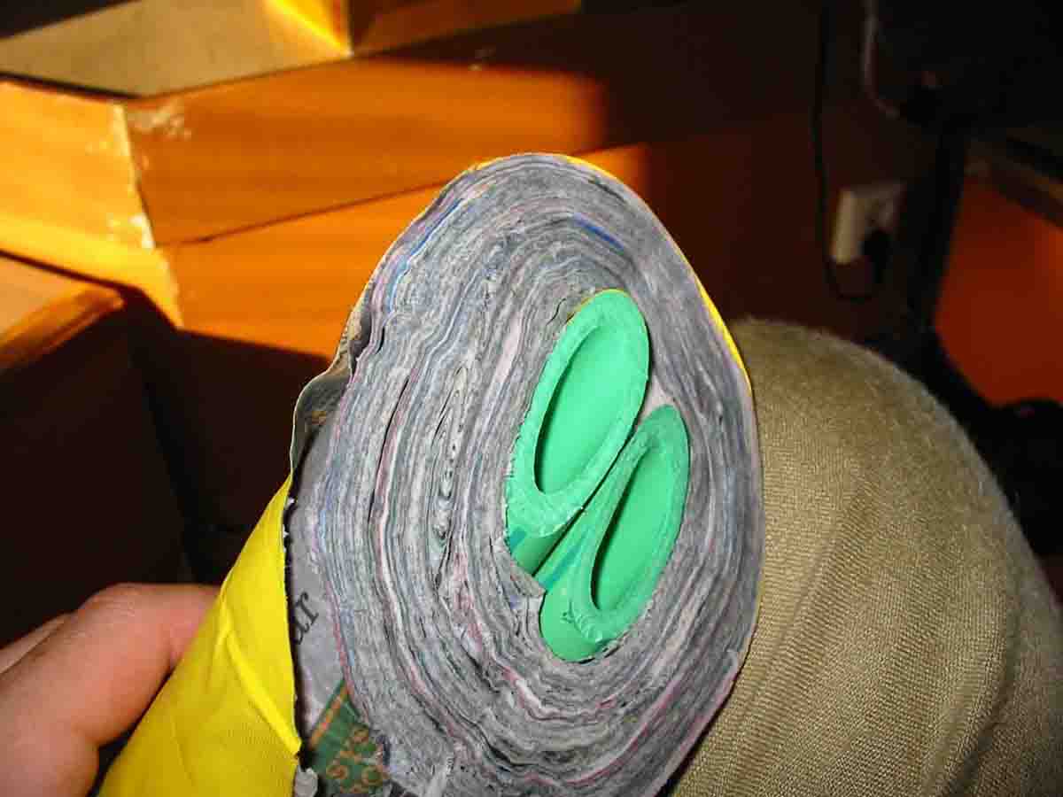

Hi David,
I can´t say that the target I suggested is *exactly* like a poor human body, only that it approximates more closely than most other test cutting materials used. (apart from the obvious pork chops...)
The glue in duct tape does not hinder so much as the layer is very thin. It is different with a solid gelatinous material without a lubricating fluid (like ballistic gelatin).
You need some tape to bind the news paper down. Duct tape is one option, but you could perhaps use some other adhesive tape that is thinner and less tough if you like. Experiment and see what works best.
The real issue is to find a good plastic pipe to mimic living bone. That is the hard part.
You can then vary the donmension of the pipe and the amount of paper to vary different target areas.
Fresh vine or some other semi hard fast growing plant could work very well. Especially if it has a hollow or porous centre, as suggested above. Only be sure to use freshly cut vegetable matter for this application. It makes for a great difference.
The main idea is to get close to what could be thought as realistic. It is sometimes a good idea to use a realistic target instead of soda bottles, just to hav something to correlate to. No need to get too gory with these cutting practises (unless you absolutley want to, but then make sure no one with easily offended feelings is watching!). The idea is only to get a proper perspective on cutting performance and the dedication and finesse needed for various cuts described in the fencing manuals. What is needed for a cut to be effective?How much movement and force? What speed? What is possible with different types of swords? What is the pros and cons with various designs through the ages. Much can be learned through this.
Unfortunately I do not know of an American equivalent of this plastic pipe, but we are working on it at Albion to look it up. I brouight with me a length during the latest visit.
I will keep looking and post the reslt on this forum when I find the material.
Fusiotherm is available in Sweden, so I guess you could get it in all of Europe?

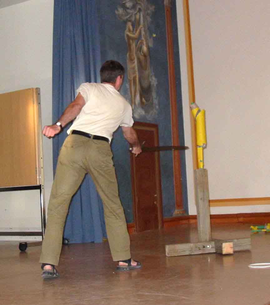

Petri Peltola
Posted: Thu 28 Oct, 2004 12:37 am Post subject: |
I have a couple of pics of testcutting from Peters lecture during Visby medieval week 2003.
Here they are if I can figure out how to attach them
Attachment: 48.23 KB
Peter is cutting with his Solingen (I think) here. [ Download ]
Attachment: 53.34 KB
Here's the cutting target Peter described. This one's about the thickness of my thigh as you can see. [ Download ]
