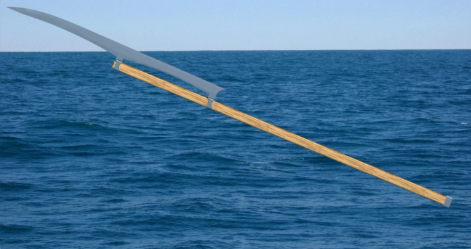

PostPosted: Sun 31 Jul, 2011 7:24 am    Post subject:         Reply with quote
I recently went surfing the net looking for viking weapons for my re-enactment group and found this topic. My uncle has been re-enacting since it wasnt re-enacting and didnt like the look of the weapon from MRL so we sat down with a CAD program and decided to 'fix it'. after 6hrs and 5 revisions we ended up with :
The haft is 1.3m (4ft 3in and a bit) long and 32mmx20mm (1.25"x 0.8")
The blade is 84cm Long (33in and a bit) (an Ell is (apparently) the measurement from your elbow to your fingertip, 17-18in)
33cm (15in) of the blade overlaps the haft
The total length of the weapon is 1.734m (5ft 8in and a bit)
The point of balance is 6cm (2.5in) below the lower socket (perfect for 1 or 2 handed use)
The weight is 1.207kg (2.66lbs) including the 90g (3.17oz) counterweight
The first 3" is diamond section ( fulfills "ending in a four-edged spike")
At its thickest point the blade is 4mm (0.16in) thick
at the narrowest point between the 2 sockets the blade is 32mm (1.35in) wide
At the upper socket the blade is 50mm (2in) wide (from the back of the actual blade not the mounting point)
From the back of the bottom socket to the edge of the blade it is 85mm (3.3in)
From the back of the top Socket to the edge of the blade it is 91mm (3.5in)
Any thoughts?
 Attachment: 180.11 KB
My interpretation

PostPosted: Sun 31 Jul, 2011 10:39 am    Post subject:         Reply with quote
Will,
I think your interpretation is nothing short of fantastic. It's a shame Hank Reinhardt isn't alive to comment on this.
If this goes into production (I can't afford custom prices at the moment), please send me a PM, as I'd buy one in a heartbeat.

PostPosted: Tue 02 Aug, 2011 5:04 pm    Post subject:         Reply with quote
That's what I've always imagined an Atgeir would look like. Some say it's more likely to be a wide bladed heavy spearhead instead, but no one really knows either way today. It certainly looks plausible to me.

PostPosted: Tue 02 Aug, 2011 6:04 pm    Post subject:         Reply with quote
That looks really good. Now you just need to get someone like A&A to make it.
