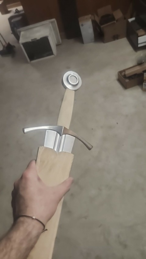

PostPosted: Sun 26 Oct, 2025 4:30 pm    Post subject:         Reply with quote
Bit of thread necromancy here - checking the date on the initial post will take us back to 2012 Happy
(by the way... special thx to photobucket for ruining my post pictures along with millions of others!)
But some progress on my custom Albion prince! I did wrap the grip a couple of years ago and made a wood-core scabbard even earlier than that... now onto a suitable scabbard. I will do a belt wrap and maybe will get a period-accurate buckle and strap end too. I'm happy, as I haven't done any leatherwork in a while, yet this is the straightest seam I've achieved, and the fit with the shape (bought from Tod more than a decade ago) is spot on. The first batch of pictures shows progress before the rain guard was trimmed and sewn.
Next, the belt wrap, my leather is too thick, so I have to find a way to thin it down. Then some carving, maybe, dye, and it should be all done. I'll post some pictures of my custom Albion moat (that one with the yeoman is some of my best work for sure).
Hope you like it!

Julien M
Location: Philadelphia
Joined: 14 Sep 2005
Posts: 1,093
PostPosted: Tue 16 Jun, 2026 8:56 am    Post subject:         Reply with quote
Hi Michael,
Thanks for your kind words. No progress on this one since the last update, been sidetracked by other projects (sample below), but I will wrap this one up soon - stay tuned!
