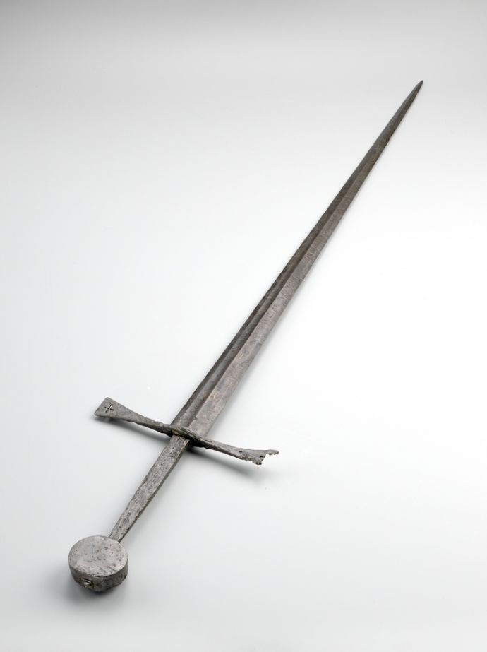

 Attachment: 21.89 KB
National Museum of Slovenia N 4516, early 15th century [ Download ]
