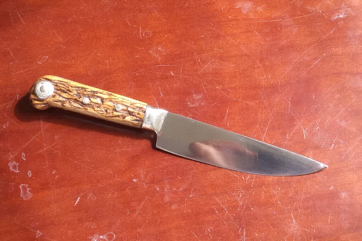

Thought I'd share this little project. It's made from a "Spanish mini-belduque" that can be acquired from several sellers.
The wood faux-antler scales aren't entirely convincing in person, but, eh.
So, I was wondering if anyone could recommend what I might use for the fork, bodkin and cleaver. For the latter I had the idea of perhaps using a machete in the 12-inch range. It's my understanding that a meat cleaver should have a very heavy blade for its length.
 Attachment: 442.07 KB
Full-size pic if you don't want to wade through the whole spiel at my blog to get to it. [ Download ]
