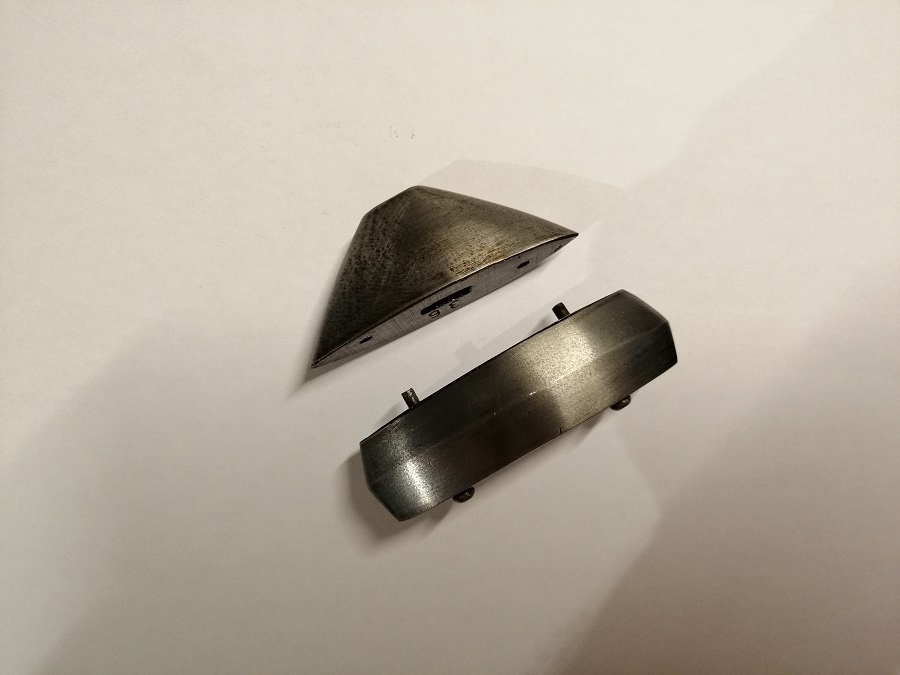

Well, within this price range my expectations were quite low. But after unpacking the sword I must say for 99bucks you get a quite solid piece of a "sword". I just call it " sword" because in the current state and form it is to heavy and feels just dead in my hand (no distal taper at all, fuller is too narrow) It also has a few symmetrical issues like a lopsided pommel, the holes in the upper guard are quite off and the blade has two noticable bends. But the overall construction is not bad at all. I really like that they went for a two-part pommel. Also the tang is beefy enough for my taste. It could be broader but it should do well. Better than some of other makers in this pricerange, for sure.

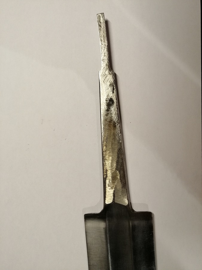

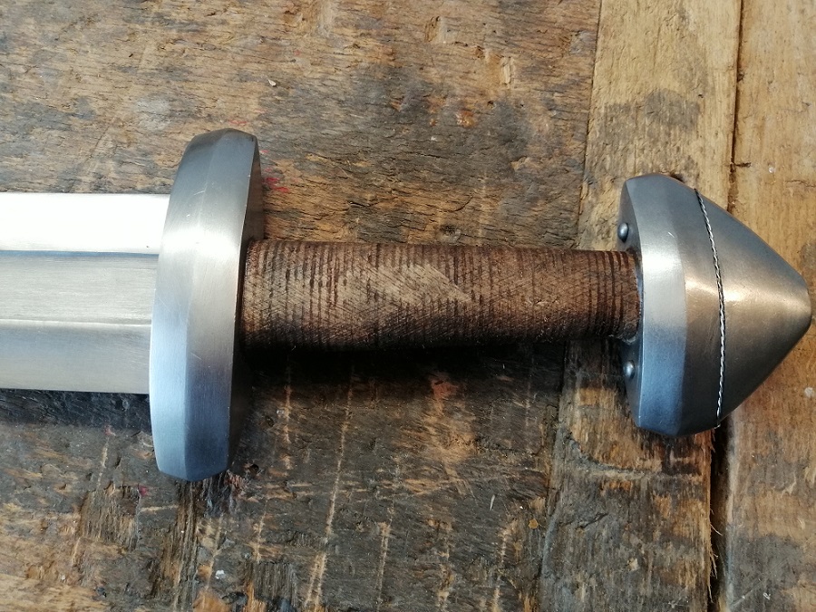

I will try to upload some fotos of the progress but it probably will take me a while to get this project finished...But hey. the dark season has just begun. Here are some fotos of the dissasembly.
Stats now:
overall weight: 1432g
blade weight: 834g
pommel weight: 305g
crossguard weight: 279g
lenght: 97cm
grip lenght: 10cm

Actually, the fuller width and even the lack of distal tapering was something of a feature of Migration Period/early Viking Age swords. Having said that, I think distal tapering is a good idea, and certainly there would be nothing wrong with widening the fuller - both styles are in evidence for the period, IIRC. I only mention this since it is not really necessary to widen the fuller, even if it would definitely help with the balance, if only to save work.
The shape of the lower/upper guards and pommel are fairly typical for Petersen Type H swords - I would not modify the basic shape further.
If you really want to "pimp" this, I would suggest using a hacksaw to cut shallow (.5-1mm deep) parallel lines on the lower and upper guards, and pommel, and inlay with brass, copper, or silver wire.
Look forward to seeing progress on this!

Fwiw, it looks not all that bad to me so I suggest less (work) may be better? From pics...
Unclear grip area needs to be shorter?
A bit smoother (less abrupt) fuller edges may gain most benefit?
The pommel pieces also look maybe somewhat "too angular", maybe just a bit smoother would be good?
Just off cuff ideas fwiw, & can't judge feel from pics. Thanks for sharing & please let us see how it turns out.

Your absolutely right with the fuller. But I want it to feel lighter and better balanced and with a grinder it's actually not that much work to widen the fuller a bit. And yes the fuller egdes need to be smoother.
I thought about inlaying silver wire. Could be an interesting task. I might give it a try.
Concerning the shape of the pommel and crossguard. Yes the form is correct. No need to change anything except smoothing out the lines a bit. BUT... The cross guard is way to massive for my taste. Thickness needs to ne reduced a bit.
I'll try to get close to the dimensions of the Albion Hersir. In my eyes that's the sword Deepeeka tried to copy, anyway.

What are you going to do to grind a proper distal taper?

David Lewis Smith wrote: | What are you going to do to grind a proper distal taper? |
I used a angle grinder for the rough stuff. The next step will be using a belt grinder and file.

Thanks for the stats. Since the model I try to stay true to is the Albion Hersir I chose following measurments for the thickness of the blade. At the tip 2,2mm and at the cross 4,3mm. But I have to admit I am already a little bit below the 4,3mm at the cross, because I widend the fuller quite a bit. The thickness at the cross is now around 4,2mm. The tip is at 2,5 now. Next step is refining the fullerlines with the beltgrinder and then refine the bevels. I will probably end up a little below the 4,2mm at the cross and hopefully around 2,2mm at the tip.
I have managed to grind off nearly 130g of the blade. Starts to feel like a sword blade now rather than a iron bar.

Firstly, love what you are doing here, and it looks like you chose a perfect blade to start with. It looks like it has all the right makings of an accurate reproduction if you can just refine the geometry a bit. May I suggest that you attempt to hollow out the pommel some? In period these pommels were nearly always hollow, and I assume this will improve the historical accuracy of the balance. Also, a hollow pommel will put you above nearly every modern reproduction since it is almost always ignored.
