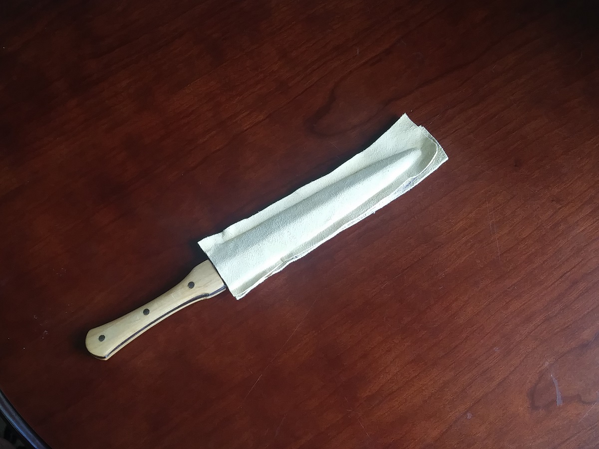

PostPosted: Mon 31 Aug, 2020 6:27 am    Post subject:         Reply with quote
I've been doing some experiments. It seems like dissolving rosin in rubbing alcohol and letting it evaporate until thick and syrupy yields a glue that its more-or-less as effective as rubber cement. Both adhere chamois to wood, but peel away fairly easily. (Of course, the dried textures are different; the rosin is hard, the rubber cement, well, rubbery.)
Melting together rosin and beeswax about 3:1-2:1 appears to make a very strong hot glue for this purpose. If I try to peel the leather off the wood, the leather rips up before the glue fails. The only trouble is that of course it thickens and hardens fast. The glue and leather have to be applied in stages, and even with careful use of a heat gun (including heating it after finishing applying the leather and pressing it against flat surfaces to smooth it out), my test scabbard is turning out slightly lumpy.
I bought some rosin/wax/charcoal pitch glue that seems to hold the scabbard halves together well enough, though it's also a little tricky to use.
 Attachment: 293.83 KB
